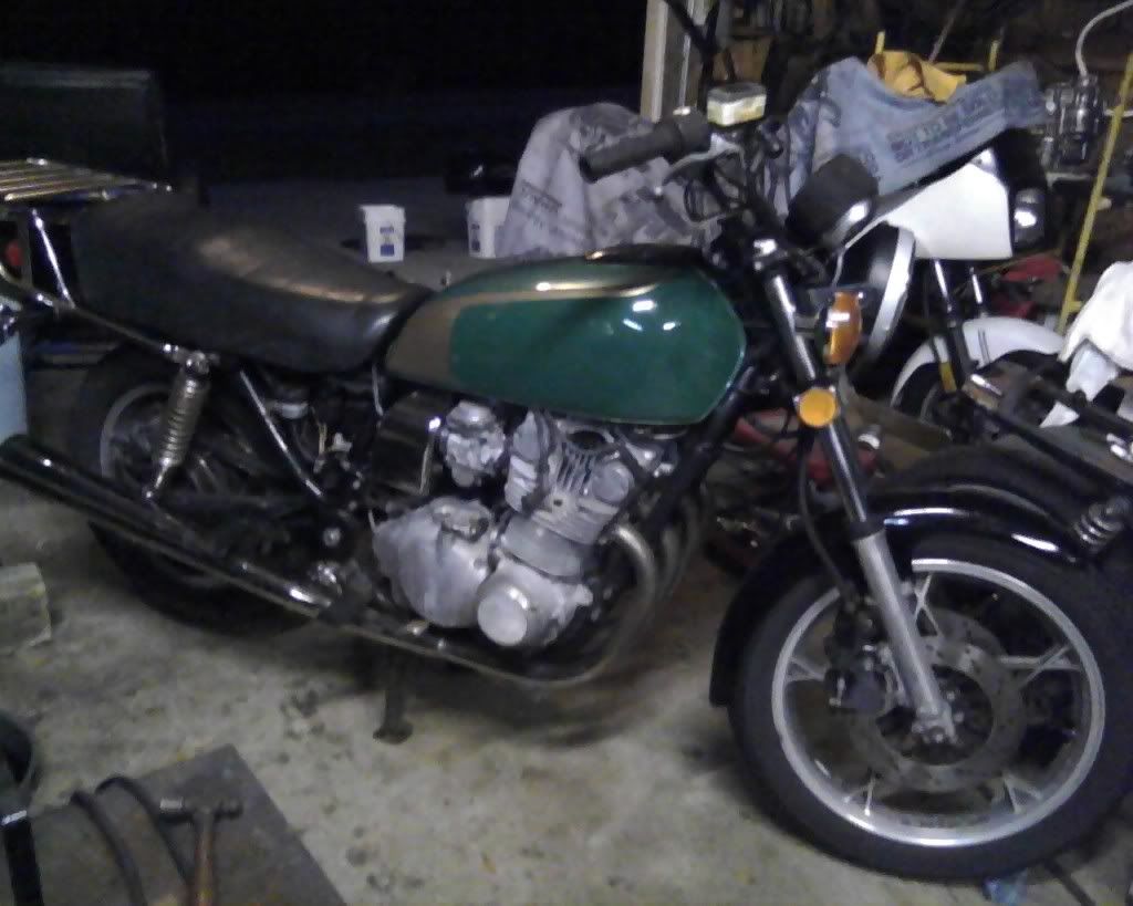

            '78-79 750E tank is what you need. It's a bolt on and go. I have a photo in my bucket here I put one on to show another member. I'll post it asap.

                              I already did. Here is the 750 the tank came off of. A $100 special.............
                              ........and on the 850G $200 special
                              A direct fit, both have the same mounting points and backbone shape. That's usually where the swapping problem is, sa some tank tunnels are too narrow to fit down over the frame and some Suzies have a two bolt vertical rear mount instead of the single horizontal mount. That and of course if the tank is physically shorter. If that is a 550 tank on the custom then he may have done some mods to make it work. I have never tried a 500E tank on a larger bike, since I've never owned one. I did have a nice '82 550T, but that is shaped like an L tank and has the twin mount.
