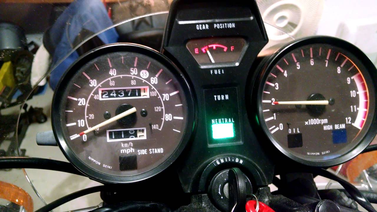

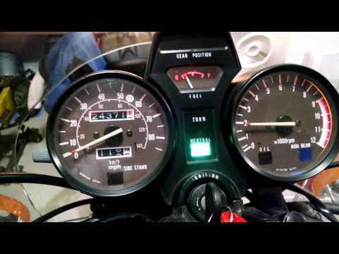

    Here is the first starter button push after I re-installed the carbs re-worked by STEVE
