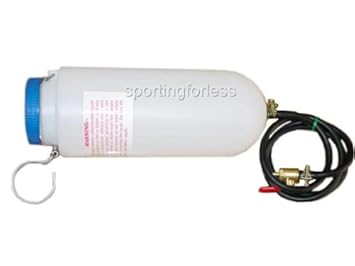

    I could use some help getting my bike to start again. I just did a top end & carb rebuild. Yes, the carbs were dipped, scrubbed, re-ringed, the whole nine yards. I got the bike to run with an auxiliary gas tank. I was still de-rusting the actual tank.
    One of these.
    Then once I finished the tank I put it on the bike and took it out for a test ride. Now I was a little too excited about going for a test ride and forgot to check the rebuilt petcock I put on the tank. I found out the next day that the petcock was still bad and pulled it from the bike. I have not been able to get her to start again sense that short test ride.
