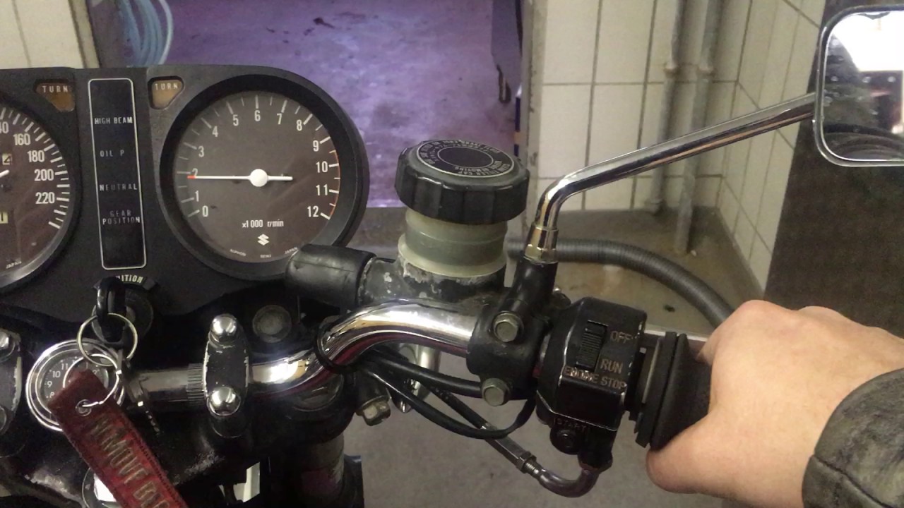

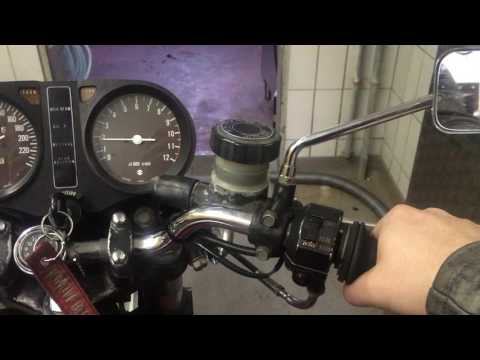

    I was just about to begin a thread on this. You seem to have exactly the same problem as me. Does this seem familiar?
    I'm also slowly reaching the point where I begin to question an air leak.

        Roeme=Yea mine will hang like that but it will not drop as easily as yours does
