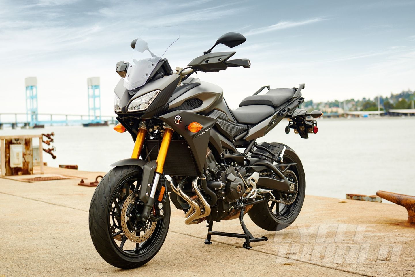

        http://www.cycleworld.com/2015/06/26...rossover-tubes
        The Bandit 1200 has such tubes, supposed to broaden the torque curve
        It must all be magic
