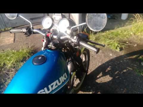

    Above is a clip showing the problem. I have a lot of experience in two stroke engines and I can just hear that something is wrong with mixture but I am not that good with four strokes like my Katana so I really don't know what hurts her... Valve clearance was adjusted like 2500 km ago so I doubt it making any diffrence.

                      Well done! In this video your bike runs great! Looks like you have the idle mixture settings at a good point now for your bike.

                          sounds Much better, than first video. Good work, Himer!
