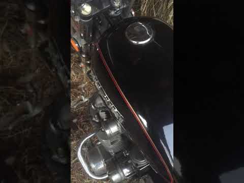

              Haven?t received the petcock yet. Mine is the 50 mm. I tried putting gas via a funnel straight into the gas line but the battery died after about 10 seconds so I didn?t get it started. I checked for pressure on vacuum line and it was fine. I will update as soon as I receive the petcock.
              By cleaning the carbs I mean complete disassembly, soaked in carb cleaner and jets checked for clogging.
                Glad you went with a new petcock. I have the same model and had the same problems. I tried rebuilding the origianl and then went with a second hand unit and only got it right when I bought a new (50mm) part. Since then all has been good.
                  Put the petcock in today. Found out the choke cable is broken 😠. Engine won?t start or run unless I hold the choke bar( not sure what it?s called) all the way to the left. Even then it runs very slow. Where is the carburetor (fuel or air) adjustment?
