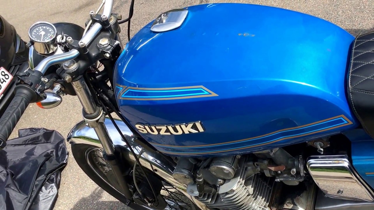

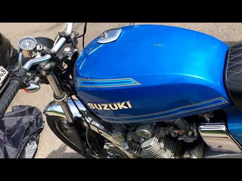

    Hi,
    The idle on My GS750 78? rises very rapidly after a very short drive (200 meters) - when the engine is gets hot. I have made a video of it, so you guys can hear how much it rises.
    I sprayed some start fluids on the intake boots before it ran hot to see if there are any leaks, but it don't seem like it.
    Any ideas?
    Thanks,
    Bo
