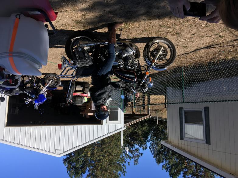

Thanks Steve. My screws are in that range more or less. I'm beginning to wonder if it may be electrical. it only happens when started from dead cold, and shows the same symptoms with choke out or in. it only lasts a minute or two, with the cylinder firing first not at all, then firing here and there, then finally correct performance. The idle is then consistent but a little under 1k. After a good ride, (motor performing great) the idle also smooth and consistent a little over 1k. It's not a big concern, but I do want it to eventually run like new.IMG_1648.jpgEastern Washington

What brand of tires?
They appear to be REALLY sticky.
