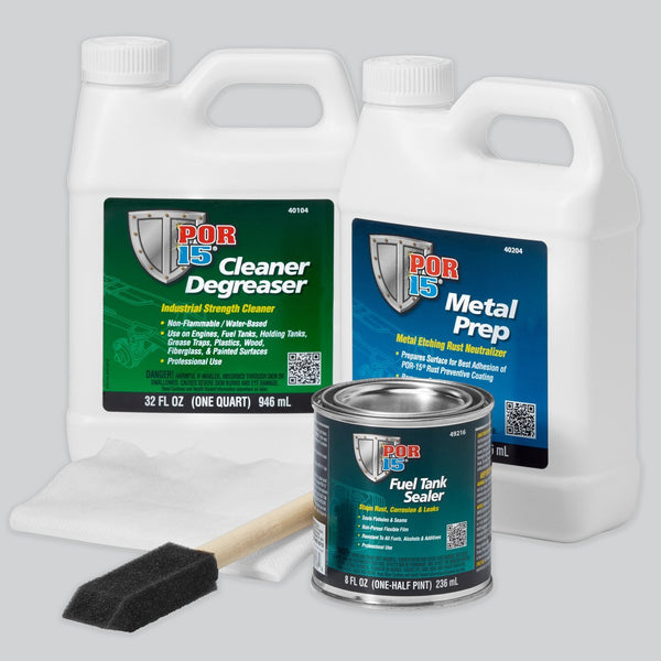

              BTW welcome to GSR, as Steve mentioned let us know what model you have and also why have you decided the tank needs replacing.
              It maybe possible to repair yours if it has rust inside or small pinhole leaks by installing a liner by Caswells or POR15. I've used both and had good success.
              Caswells for larger pinholes and rust, POR15 if you only have rust and very minor pinholes.
              Lordco sells POR15, and you have a choice of 2 kits, one that includes a stripper product to remove an existing failed liner and one without.
              Repair and protect motorcycle gas tanks with POR-15. This fuel tank restoration kit seals leaks and creates a durable rust resistant interior barrier.
              Good luck and let us know if you need anything else.
