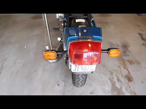

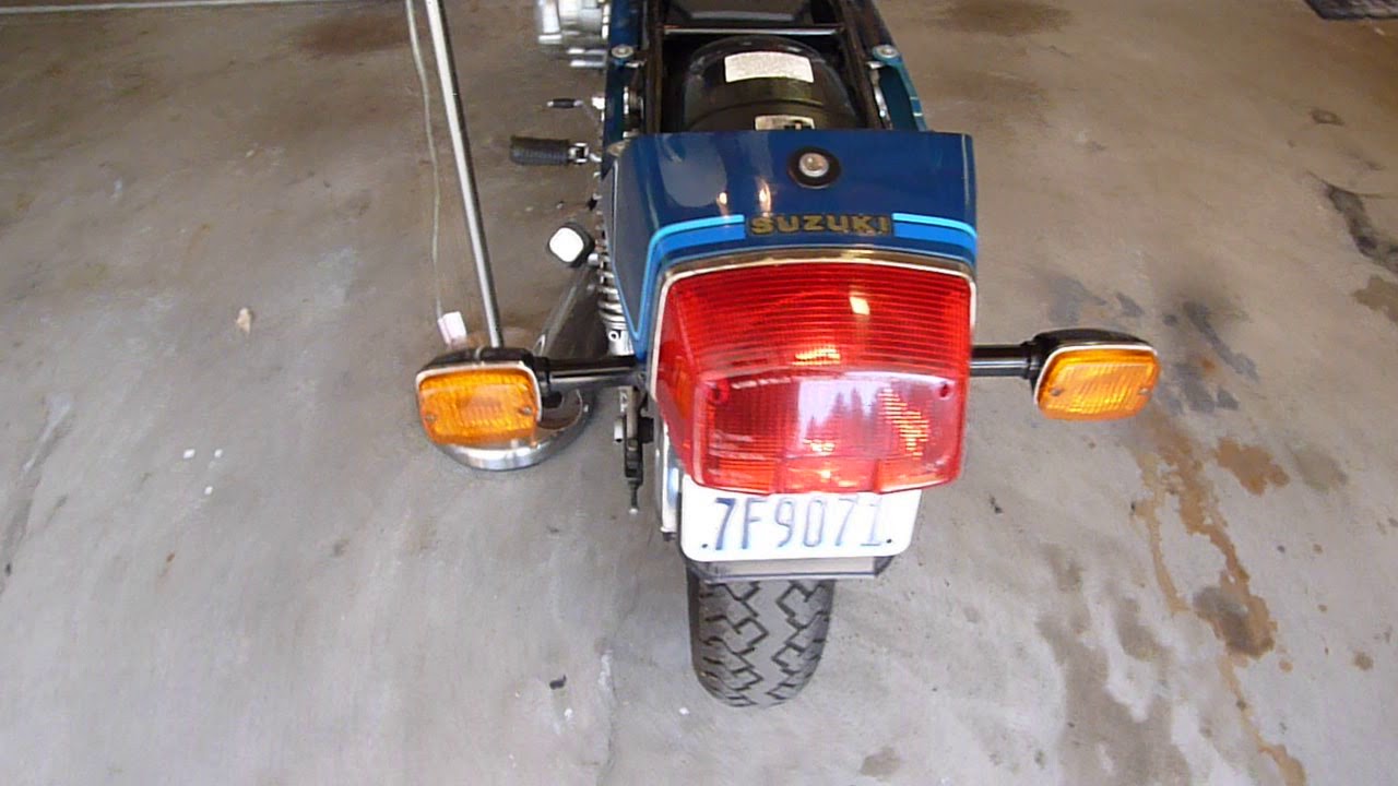

    Been running some Seafoam through the carbs the last few days, seems to be improving but I'm going to need to clean and rebuild them correctly. Short video, how's it sound?
    It's always hard to tell how any bike 'sounds' via a video. Your pipes don't look good, if you're doing your carbs properly you might want to check your valve clearances while you're at it. You're going to need to re-balance your carbs anyways from the rebuild might as well do a thorough job and do that valves too.

          Your pipes dont look good , very blue. Blue is heat and that says lean . Your throttle response off idle sounds lean also . Yes, what everyone is telling you ...pull carbs and do it the right way. Nice bike, I have the black '81 GS1100EX . I believe the blue model was the rare one, have only seen a hand full of them in all these years . A good one to hang onto .
