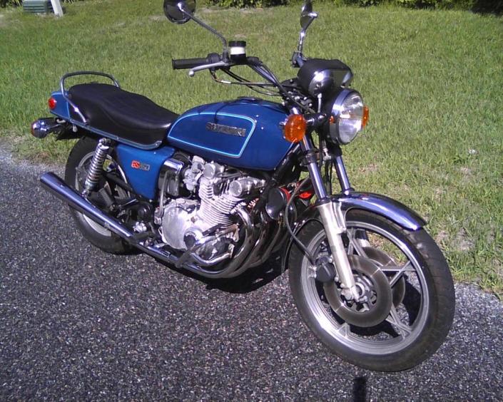

          L models have chrome rear fenders, small gas tank, big step in the seat and a leading axle front fork, among other things
          Post a picture of yours

                To answer your original question, the 77-79 standard and E models all have the same tank
                So, no mounting issues
