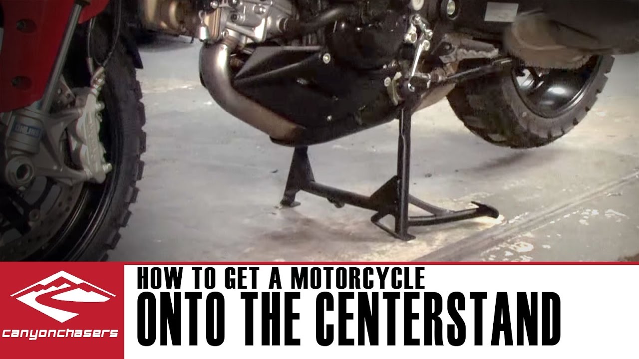

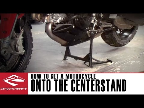

    It also says to keep it on the center stand, but I can't really figure out what kind of witchcraft I need to use to make it work (I weigh like 90 kilos and still cant get it ontop of it).
        I, and a lot of other folks, used to struggle getting the bike on the center stand as well. Once you get the technique down, you'll wonder why you struggled with it so much. I only weigh about 70k (155lbs.) and I can now do this with no problems at all. It's more about driving the center stand into the ground with your right foot (I stand on it fully), then it is about lifting or pulling with your arms. This video shows/explains it probably as good as any I've seen. Really all your arms do is gently pull the bike to the rear. If your stressing your back and arms/shoulders, you're doing it wrong.
          • 5804
          #34
          ... or you have sacked-out springs. A loss of half an inch (and these are 30 to 40 year old springs, remember) will make you struggle.
            #35
            Thank you! I went to work and I did it, I dont think I have the handle but the frame under the saddle was fine. You are right, it doesn't take a lot of power.
