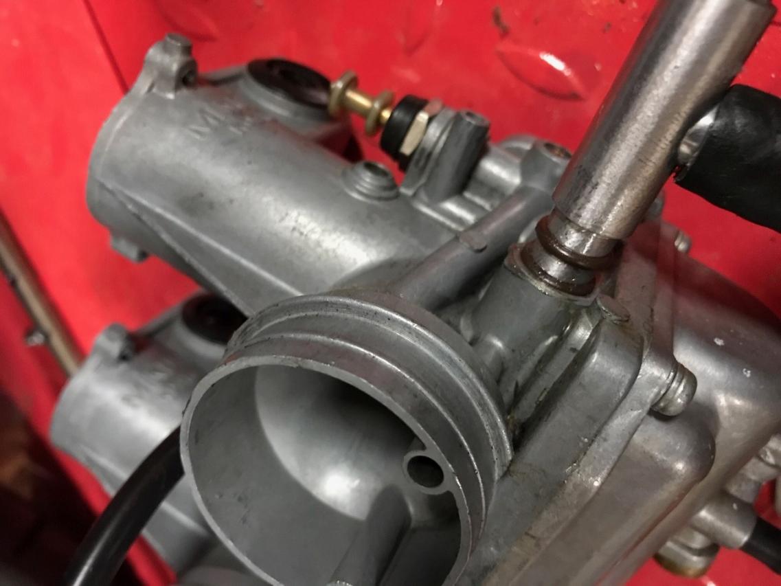

Has anybody installed one of these in their GS? Better yet, did you have fitment issues? I got 1 side of the Tee to fit into either carb, but the other Tee side was either machined wrong or the Orings are to thick. I have put bearing races in the deep freezer before to slightly shrink them for easier installation but fear the Orings would just become brittle. I have also reached out to Z1 to possibly swap this one but of course they are in FL and I'm in WA.'79 GS850

I remember having similar problems. I think I just lubed the one with tire lube and it eventually slid into place.
Either that worked or maybe I had to replace one of them. Not sure, it was a few years ago.Larry

You need nitrile for those o rings, not viton.Originally posted by derekb View PostI tried the trusty petroleum jelly but that encouraged the oring to slide out of its seat. Maybe Ill pick up a couple viton orings at the store today.1978 GS1085.
True, but they are all suited to different applications. You wouldn't want those O rings to fail, fuel leaks are never good at the best of times and it wont be a quick fix if they do.Originally posted by derekb View PostBuna, Nitrile and Viton are all gasoline compatible. Got any tips to install?
I have installed quite a few of these Tee's and personally never had an issue. Just make sure the orificies are spotless clean and with a bit of lube, they slide in, nice and snug.1978 GS1085.
My Z1 fuel T leaked with the orings that came with it (78 GS750). I reinstalled with the o-rings from the Robert Barr kit and have not had any trouble since.Originally posted by derekb View PostHas anybody installed one of these in their GS? Better yet, did you have fitment issues? I got 1 side of the Tee to fit into either carb, but the other Tee side was either machined wrong or the Orings are to thick. I have put bearing races in the deep freezer before to slightly shrink them for easier installation but fear the Orings would just become brittle. I have also reached out to Z1 to possibly swap this one but of course they are in FL and I'm in WA.Regards,

Anybody have the size of those orings written down or committed to memory? Should probably get some for mine (stock) due to a very slow leak (more like seep)1980 Yamaha XS1100G (Current bike)

11 OD
7 ID
2 thick
All in MM
Z1 sent me 2 different sized orings on the Tee. They are shipping me 2 more of the correct sized rings and Ill be good to go. HMMM Or go to HF and buy a nitrile 300pc set for 4.99 with an additional 20% off coupon. Im actually going to wait. hahaLast edited by derekb; 03-03-2020, 06:37 PM.'79 GS850

I had the same problem with that Tee. The O-rings are too fat. I replaced the originals with some from a Harbor Freight O-ring variety pack. Can't remember the sizes though. At any rate, I was not happy with that Tee and wouldn't recommend it for that reason.Ed
Tee and crossovers are great....just the wrong orings. Maybe someone with a spare from Robert needs to send Jeff or Chris one so they can order the correct sizes to send with them???MY BIKES..1977 GS 750 B, 1978 GS 1000 C (X2)
