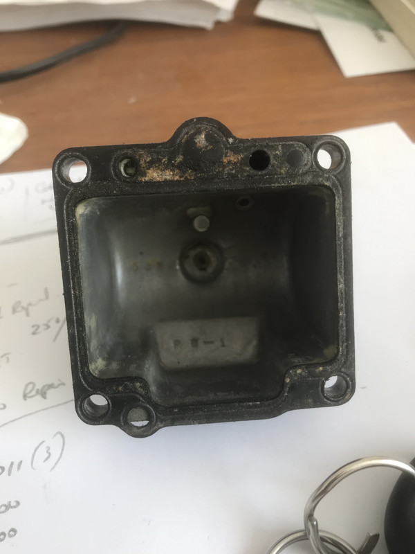

    So far I have tried:-
    Malt Vinegar 5%
    Apple vinegar 5%
    Bi-carbonate of soda
    Coke
    Carb cleaner
    ...and nothing is shifting this varnished old fuel from the carbs, jets and tubes.
    Anybody else suggest something that will at least soften this off.
    I know we cant buy Berrymans carb cleaner here in the UK so that's a non starter option.
    This is what I am trying to soften off...

    Cellulose thinners will shift it no problem and you can still get a can easy enough.

      Acetone... I don't know how chemical laws work in the UK, but acetone will make short work of that. If that's not available, just go with a good carb dip, like Berrymans, or Gunk.

        Cheers HH. I will see if I can get some.
        Yes it is. The jet thread is also damaged now. I have a new one on order.

          Acetone is more likely that Berrymans here in the UK.
          It wasn't dropped. I had to get a little aggressive to get it out after 24 hours of soaking and thats where the damage occured.

                When I stripped the bowls off a few days ago....
                ....about 3 minutes with Nail varnish remover supplied by my daughter.... (its acetone in another form)

                    Cellulose thinners is trivially available in the UK. Contains acetone, xylene and all that good stuff.

                      The throttle shaft seals could be damaged by acetone so be careful what you dunk.

                        I'm soaking jets, emulsion tubes, washer and pilots in acetone. I have the floats, float needle housing, float needle, screw, locating bracket and pin in white vinegar cleaning over night to get the worst of the varnish/old fuel off the carbs.
                        I washed the inside of the float bowls out with acetone to remove the sludge and caked on blackness from the old fuel and then washed stuff out. I wasnt going to go mad and shove it in the carbs.
                        I have used acetone one a paper towel and wiped the slide and needle clean making sure not to touch the diaphragm with the acetone as the slide and needle have a load of sticky fuel on them.
                        Then it's the carb bodies. They still have chokes in and mixture screws.
