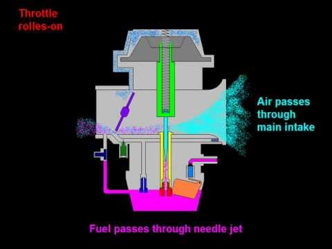

      Here's an animation showing what happens when the choke is opened.

                    hi roger nice video thanks for your help but not how my choke works mine is a 1982gs550l and when choke is pulled a slide opens up a hole under the diaphram trying to work out how this richens the mixture! regards paul.

                      That video is not perfectly correct, but it's close enough to give the idea.
                      First of all, "choke" is a term that does not technically apply here. What we have on our carbs is an "enrichment system". The system does the same thing, but it does it by opening specific ports to supply a richer mixture not by closing off the inlet of the carb to choke it.
                      If you actually had the carbs all the way apart, you would have seen the brass plunger that would slide horizontally to uncover that hole under the diaphragm. When holding the plunger, you should have seen the pin on the end. When the plunger is pulled to richen the mixture, the larger barrel part uncovers the air port, that pin moves away from a fuel port that goes down into the float bowl.
                      One other thing to note is STARTING TECHNIQUE. Because of the way the enrichment system works, it relies on the high vacuum of a CLOSED throttle. When trying to start the cold engine, you turn the key ON, move your "choke" lever to somewhere between 1/2 and full ON, pull the clutch lever and push the starter button. Do NOT touch the throttle. If you move the throttle AT ALL, the open throttle butterflies will destroy the high vacuum that is needed to pull the gas through the enrichment circuit. Once the engine is running, adjust fast idle speed with the "choke" lever, NOT the throttle.
