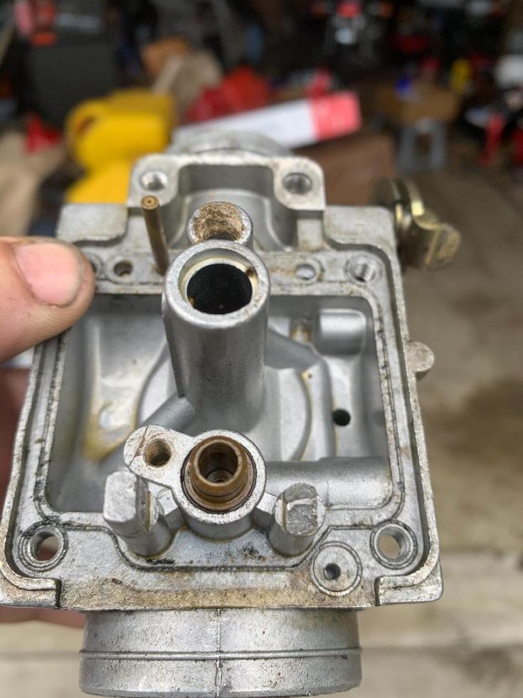

                        update: pulled the carbs apart.
                        left side carb looks real good
                        right side carb is missing a float post. the post was NOT in the bowl.
                        been looking most of the day, and i cannot find a replacement anywhere.
                        guess im *@%^$*@%^$*@%^$*@%^$ out of luck on this bike

                          Is the post gone or the pin?
                          1982 GS450txz (former bike)
                            the whole post is gone. the pin is there, but its bent up a little, which im guessing was causing the float to stick and flood the carb.
                            no idea how or if it can be fixed. pics in link

                              another pic
