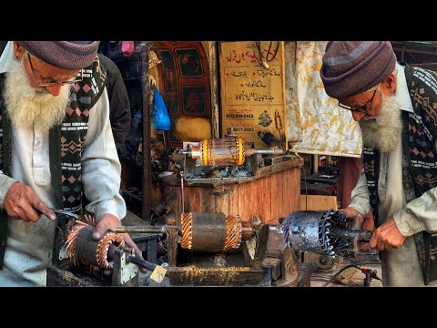

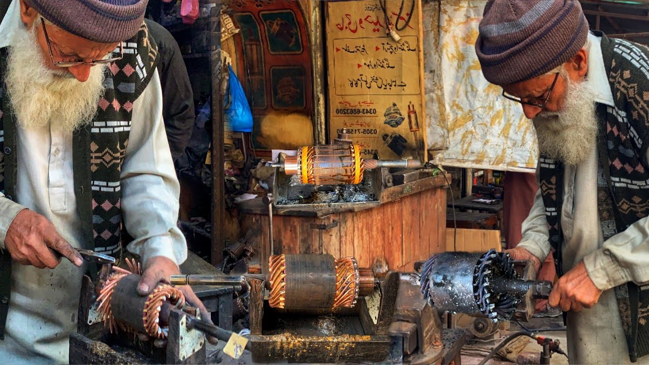

    Hey Chuck, sounds like found a new hobby to tinker with…
    Give this guy call, bet he's got the answer.

        Watching that video, Looks like they're being rebuilt with mostly original parts cleaned up, plus all new insulating material around the copper.
        I suspect your weak starter motors have shorts because of fried off insulation, just as what happens to stators.
