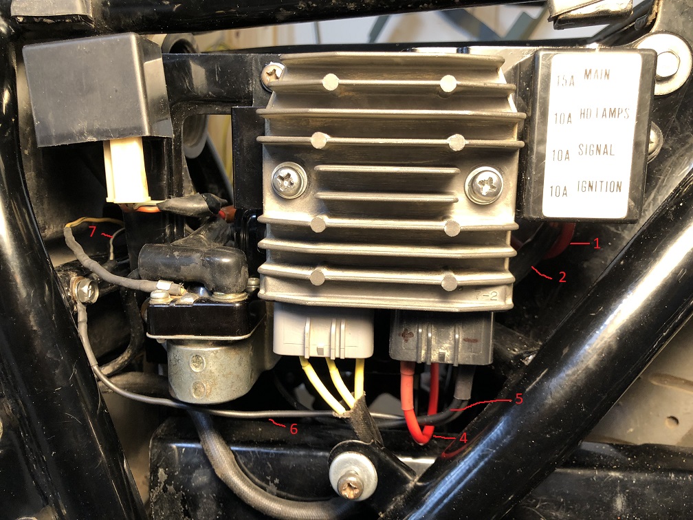

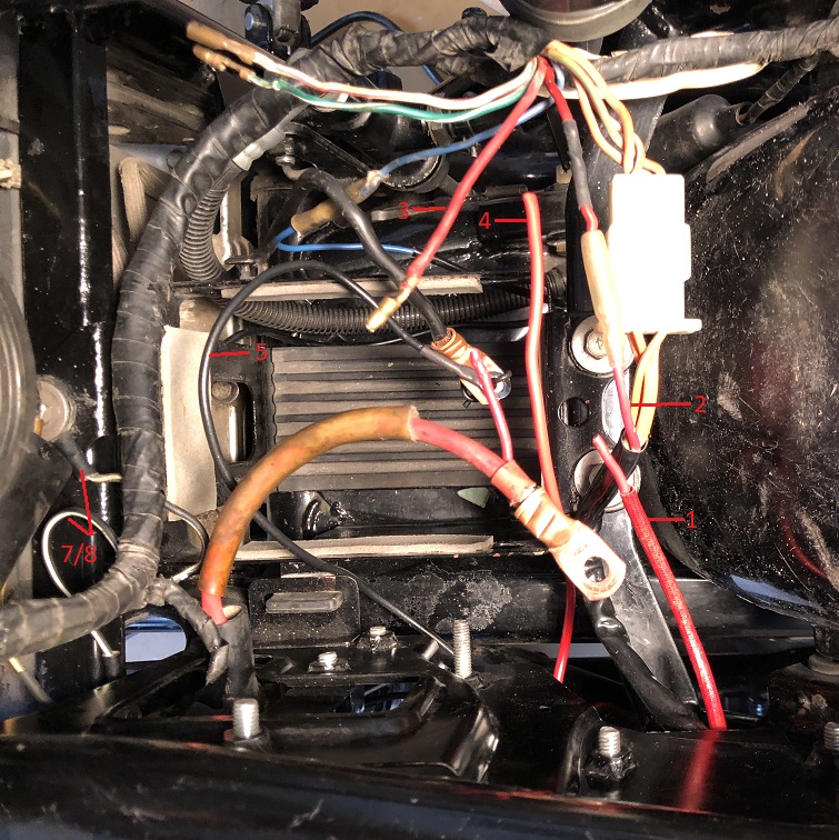

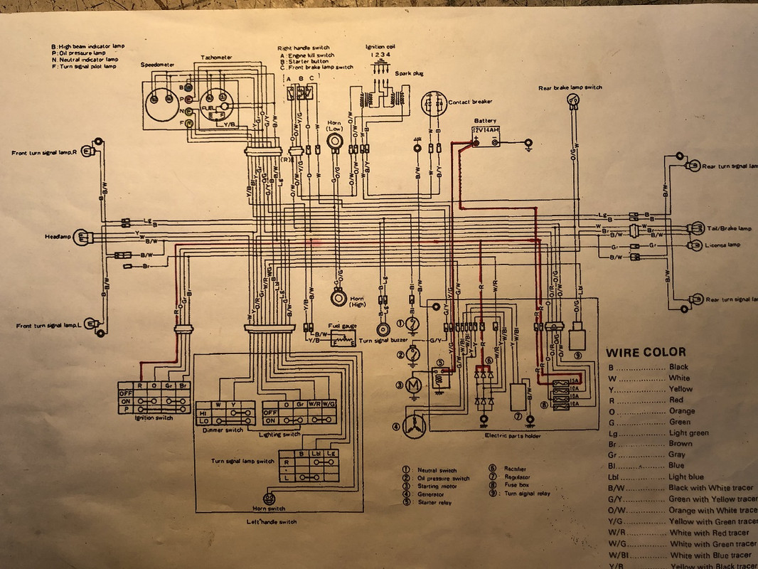

    The '79 GS1000's conversion to a SH775 RR has come to a standstill. My brain won't compute any further, even with the huge resources of the archives.
    The 3 stator wires to the SH775 is straight forward. Done
    The black ground wires are too. Done. At least I believe so.
    The red power wires are causing brain smoking grief. I would be eternally grateful for advice on which wire (and an inline fuse) goes where.
    Red 1- separate wire from fusebox, had bullet end
    2- bundle of 4 orange and 1 red in sheath from fusebox. red is correctly connected, I believe.
    3- coming from main harness
    4- new wire from RR (+)
    Black 5- new wire from RR (-) to batt(-)
    6- new wire from RR (-) to frame
    Black/white 7/8 - stock wires from harness, both grounded to frame
    Harness wires 9 -white/red, green/white, red - orphaned?

    SH775 positive output should feed into the red wire that splits: one leg into the fuse box, then battery, and the other feeding the bike proper.
    • DaveR
      • Nov 2010
      • 2404
      • Saskatchewan Canada
      Thanks for the succinct reply Nessism.
      I peeled back 4" of harness wrap and found the red wire split.
      Edit : Spent the day on the electrical and have everything back together.. All makes sense now. Many thanks Mr. Nessism
