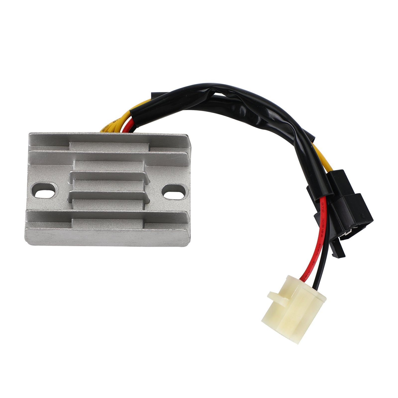

                I also intend to buy this. The cheapest possible RR that if I put on bullet connections wil fit but is for a newer gsx model. My original was small like this not like the GS 550 one in now. Without my bike folders I am lost as to the technicalities but I see no reason why this should not work .......
                Voltage Regulator Rectifier Fit For Suzuki Katana 250 400 GSX 250 400 1991 1992 Features: Direct replacement to your original unit. Plug-and-play, direct fit, easy installation. No assembly required. Higher grade of electric components. Improved heat sink and charging capabilities. The quality exceeds or meet the OEM e

                  At that price I can see the attraction. I got my 775 from a local Polaris dealer before the prices went crazy. At the time I suspected the old R/R had fried my stator but as it turned out someone had wired it up inside the generator cover with bullet connectors and two of the phase wires had fried and were shorting to the case. At the time the local scrapyard gave me a bag of six used Suzuki regulators for free. Take them he said, maybe one works, they're all rubbish anyway.
                  The reason so many recommend the 775 is that it is a series regulator rather than the original shunt type.
                  The benefit is that when the battery is charged back up the 775 switches off whereas the original shunt type keeps on banging away at full chat and that extra energy is dumped back into the stator.
                  Over time this can damage the stator and they are expensive to replace. It's not black and white. Many members here have had no issues with shunt type regulators.
                  Avoid bullet connections. Spade if you have to or see if you can get a matching plug for that regulator.
