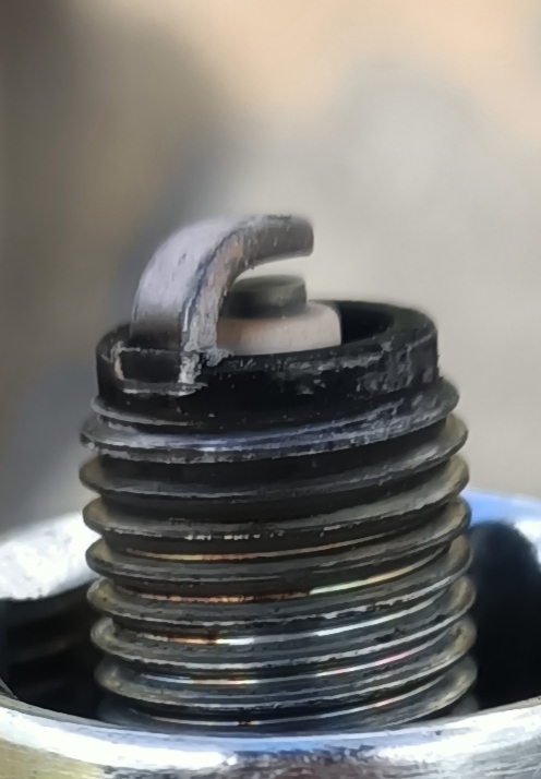

I have decided to see whether I can tune the ignition timing via the ground strap/center electrode on the plug. Has anyone else done this? Essentially the theory is that as the spark is advanced the electrode temperature rises and this is witnessed on the ground strap and the tip of the center electrode by the amount of fuel film residue that is burnt off. More advance gives more localised heat and the more residue is burnt off (assuming correct heat range). Ideal for the street is when the 'tide' mark is on the bend of the ground strap and the film is only missing at hair's breadth from the top edge of the center electrode.
I didn't take a before photo, but after a days ride, the ground strap of a well-used plug was the same colour from tip to and including the weld. The center electrode was clean and uniform. I retarded the ignition a little did a high-speed(ish) plug chop and this was the result.
This is the same plug and colour has moved up the ground strap past the weld and fuel film has appeared to about halfway up the centre electrode. The bike feels to be running stronger in the mid-range. I will take out some more timing and report back. I will confirm with fresh plugs. Any thoughts?
