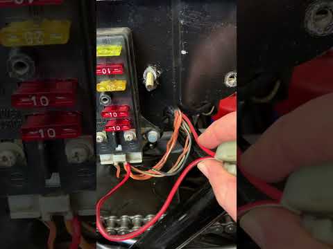

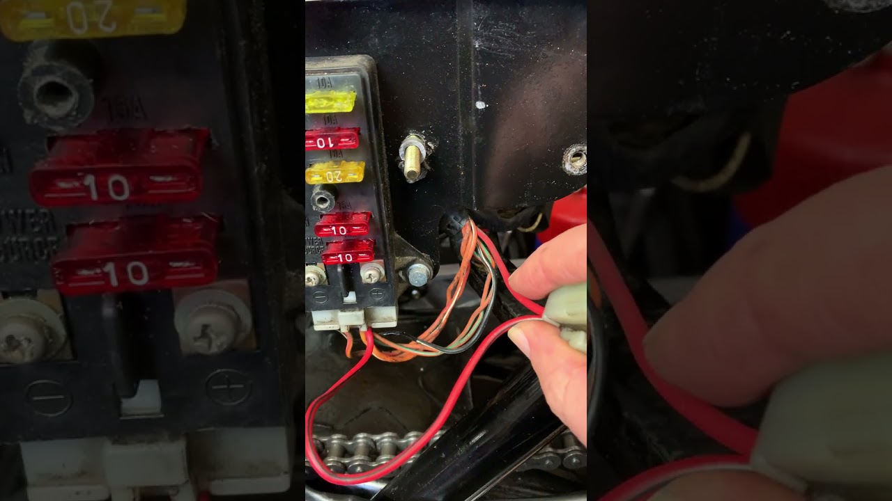

Hi Guys,
As requested...
...Here's a picture including the fuse block with its cover off.
I've also included a YouTube video shot on my phone that might (or might not) help.
Looking forward to your feedback =)
Thanks again.

Okay Sam, thanks for that video.
One thing I am not sure about is why your white 6-pin R/R connector wires are different from the picture Rich posted of his white 6-pin R/R connector wires. Don't you both have T's?
Based on this pin-out of a 6 pin connector:
it appears to me that the typical pin layout of a 6-pin R/R puts the three stator wires together, while the other three pins represent the R/R power out pin, the R/R ground pin, and the R/R sensing pin. So the yellows from the stator go to the lower three pins of the R/R.
That leaves us with those upper three pins on the R/R. And the B/Y looks to be the ground.
I suspect the two red wires represent the power wire out and the sensing wire.
So here is how I believe the the other red wires (three of them!) function.
The smaller red wire that connects to your battery + post and goes into the main harness carries power up to the ignition switch.
When the ignition switch is turned on power comes back down the main harness on a orange wire into the fuse box to power up the fuse box which powers up that R/B wire that you show going from the fuse box to the center pin on your white connector and then into the center pin of the R/R so that the R/R can monitor system voltage.
To prove this out, break out your ohm meter. Connect one probe to that smaller red wire that comes from the battery + post, and the other probe to the R/B wire (your WIRE TWO) going from the fuse block to the center pin of the white connector. There should be no continuity. Turn the ignition key on and there should be continuity. ergo: the R/R sense the system voltage!
The final red wire (the one you referred to as WIRE TWO) that goes from the upper left pin of the connector into the main harness is the R/R power out wire from the R/R. Within the main harness that power out wire is spliced into the smaller red wire that goes from the battery to the ignition switch. That allows the R/R to supply power to the ignition switch (and the vehicle electrical load) and/or to the battery to charge the battery.
To prove this out, break out your ohm meter. Connect one probe to the smaller red wire that connects to the battery + post and the other probe to the power out wire from your white connector. Should always show continuity.
So that's how I figure the PO had the bike wired. No guarantees !
