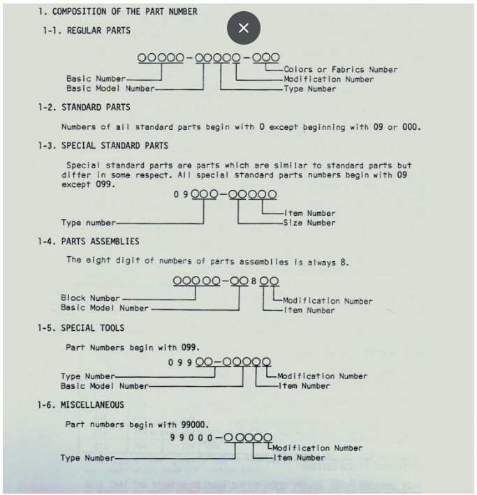

One thing Suzuki did that others didnt do was change part numbers on the very identical part from model years. Like say in 82 it was XXXXX-12345 then in 83 they made it XXXXX-12346. Same identical part but 1 number off where as others used the same number through many years until that particular part actually had a change then they gave it the updated number. no harm in giving these a shot.MY BIKES..1977 GS 750 B, 1978 GS 1000 C (X2)
There was a lot of parts sharing between models. The CMSNL website is great as it shows all the models that exact part was used on.
Some parts do get superseded and are issued a new number. But they always follow the same part code format:

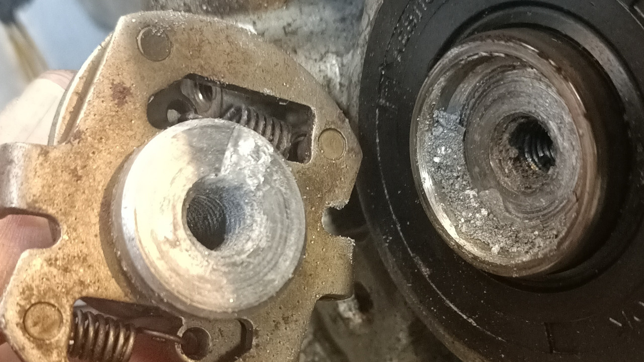

With the ATU units, as far as I know, externally they are the same and they can all be swapped. Where they vary is in the initial and full advance ignition timing and the number of degrees advance. This is controlled by spring tension and the metal stops within the unit. A troll through the spec sheets will show that different model GS have differing ignition timing especially at full advance because burn speed is a function of combustion chamber design (swirl and squish) and diameter.

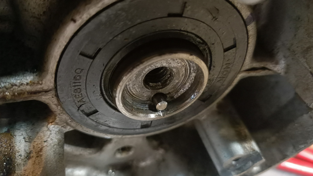

I had indexed the ignition markers during the build as I had to repair the ATU locating pin on the crank. Good thing I did as it was about 3° to 4° retarded which is a lot in ignition timing term.
I had been really disappointed with the bikes acceleration given the work I had done on the engine. Searching for the reason, I found the ATU unit that was fitted to my 750 didn't advance all the way to the full alignment (above 2,750 rpm), when set at the idle mark alignment. It dawned on me, that the ATU was off another bike (this machine was essentially a rolling wreck when I bought it).
I have since set the timing to align at the full advance mark, so at idle the timing is a couple of degrees advanced due to the short advance sweep. The only downside is that it cranks sluggishly as at starter rpm, the early spark means she's compressing more expanding burning mixture. Once she's going its all normal from idle, has really useful mid-range and screams above 7,000 rpm.Last edited by KiwiAlfa156; 09-14-2025, 11:37 PM.82 GSX1100SXZ Katana

I guess its all about locking down TDC as a known datum, as you are setting everything else off that. How you mark that is up to you. The problem I had was the index pin on the end on the crank had been sheared off by the PO (who knows how?), and who stuck the ATU assembly back in place using a wood screw buried in what looked like a generous helping of JB Weld.
I had to grind out the remains of the pin with a diamond burr and fashioned a new pin out off a 4 mm drill shank. It worked, but i couldn't really be sure the index pin was in the exact position (there was a little bit of play). Hence checking whether the T mark aligned with the pointer correctly indicating TDC... It didn't.

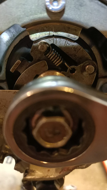

Finally got the mechanical advance unit in the mail.
I've got an allen bolt and a 19mm bolt (allen inside the 19mm) coming out of the crankshaft. Is it lefty loosey, and do I need to keep the 19mm tight? Hasn't budged yet, but I gotta get them off so I can get the signal generator out.
