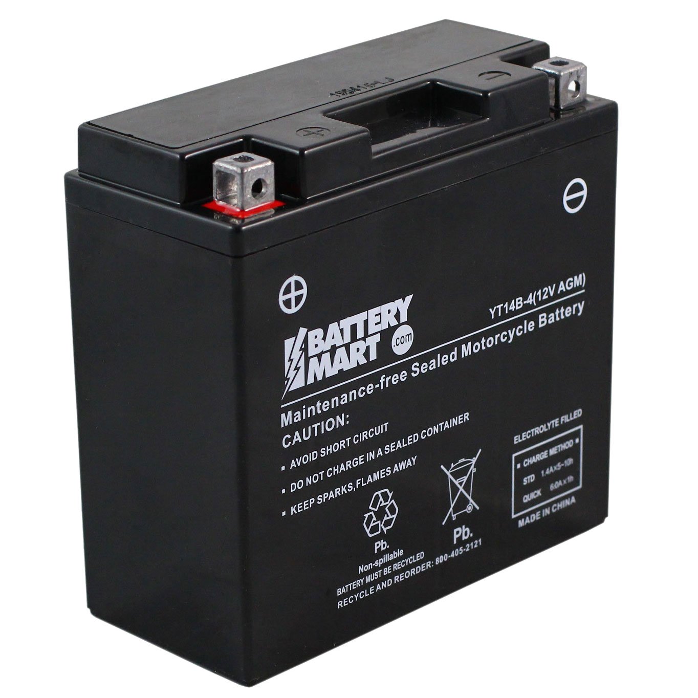

Here are some of the ones I have been looking at:
This one would be a tight fit, but is probably good electrically:

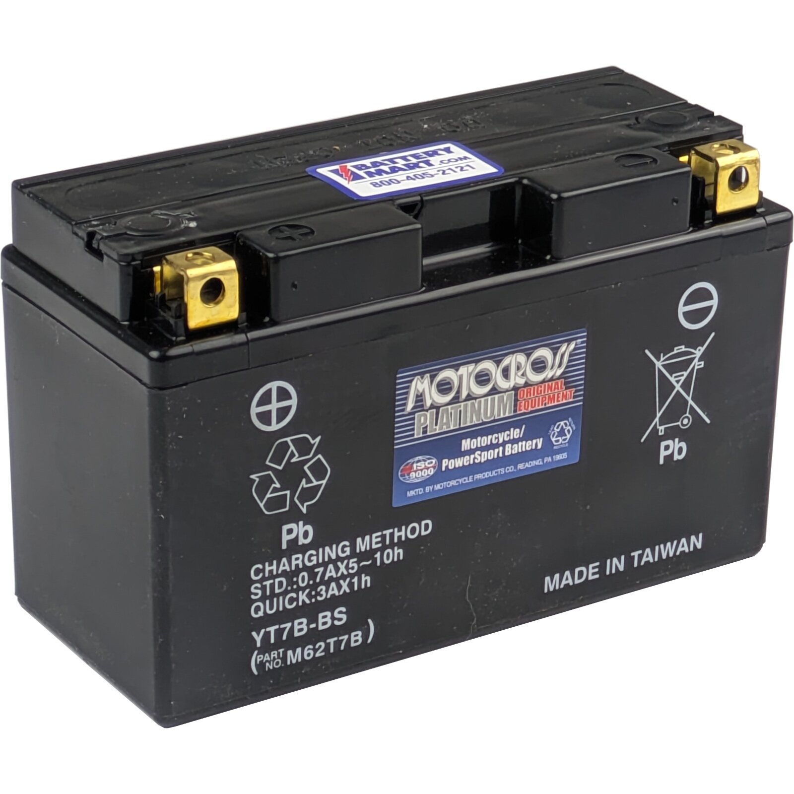

This one has good dimensions, but may be to light electrically (I may be wrong about that......I hope I am 'cause this would fit perfectly):
