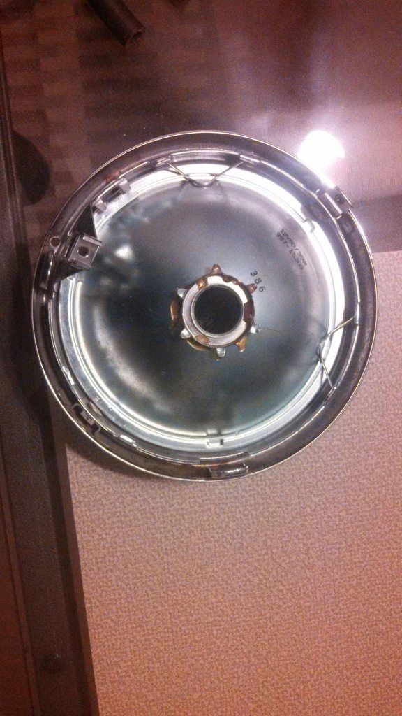

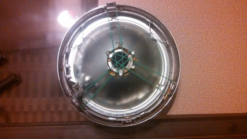

So, when I bought my 81 450T from a buddy, he said the PO had something in the headlight held in with rubber bands. Last Sunday I decided to take it apart to see what was going on, especially since I have had poor night lighting. I found the headlight unit itself, had the portion the bulb plugs into broken off/missing. The bulb was what was being held in with rubber bands. Classy! So, I figured out what parts to order, and ordered from boulevardsuzuki.com (have had great luck with them so far). Well, I went to put everything back together as it was, with new rubber bands, and noticed one of the filaments was broken. I checked the wattage and style bulb and purchased a Sylvania Silverstar Ultra 50/65 H4 bulb, and put it back in. I considered going back for a cheap one, since I had to put it in with the rubber bands, but said the hell with it. I rode for about an hour or so into the evening, and not far from home, I got a bright blue flash out of the bulb, and the LO burned out. I stopped at the gas station for a break, then decided to ride the last 1.5 mi home with the HI beam. Well, a couple hundred yards before turning on my road, same bright blue flash and the HI was gone. So, in the interest of getting home, I dropped to 2nd and turned on my right turn signal, which flashed fine then started acting up a little, then either went on solid or out completely (can't remember exactly). I switched the the left, which flashed for a bit, then went solid. Switched back to right, and it was out completely. I finally found in my service manual, that it calls for a 35/50 bulb. Now, I've been riding a good bit the past few weeks with the previous, basic Sylvania 50/65 bulb with no issues at all. Could the Silverstar bulb, with same wattage rating as the previous one, still cause a higher draw and the described events, or might it be coincidence and there is a deeper issue? I read through a good bit of the Stator Papers, and figured I might as well start there, but haven't had the time yet to start checking voltages and connections. Is this my best course of action, or have any of you ran into the same problem, and have a direct solution? I still plan on going through the charging system checks and checking/cleaning all my connections, but it would be nice to have this solved so I could at least ride to work instead of burning gas in the damn Ford V8, lol. Any comments or suggestions are certainly appreciated!

I can't really picture what you mean with the problem with the headlamp connector; there's usually a spring wire latch that holds the H4 in there, with a 3-sided connector that pushes onto the back of the lamp (bulb). Where would you put rubber bands? Or is it the spring latch you're missing? If that H4 can be jostled around in there, it'll die young. And I'll toss in that you need to make sure you don't touch the bulb's glass in any way, or it'll die young.and God said, "Let there be air compressors!"

Well, that's good to know, because the 35/50's seem to be difficult to find. I must be missing the spring wire latch. Also missing the L/R adjustment screw, spring, and square nut...but I've ordered everything I could find. Couldn't find the screw, but hoping to be able to pick that up at a hardware store, if I'm lucky.Originally posted by robertbarr View PostNo, we're interested in the voltage when the bike's running.

Here's a pic of the headlight unit
And one of the rubber bands, though I don't have a bulb right now to put in it, but hopefully you get the idea

Hopefully you can view those pics...I linked them from facebook, which I'm pretty sure I've done in the past. They don't seem to be displaying here on my end though.
Can't see the pic's I'm afraid... but my stock E headlight's plastic mounting bit for the bulb was worn, used to flop about when it came unclipped, and blew bulbs constantly.
I now have an aftermarket light on there with a standard H4 bulb in it and it's miles better. From memory it's a standard 60/55W bulb and my charging system has no problems driving it, but I have a new stator and a Shindengen SH532 R/R on there rather than the stock dodgy Suzuki items.

Here's the back side of the head lamp unit
And here's how they had rubber bands attached to hold the bulb in. I didn't have a bulb at the time, but I'm sure you can see how it 'worked'...
Yes, interesting "fix" there...
That looks quite a bit different to the 7" on the E models... mine took a special bulb I had to buy from Suzuki, not a standard H4 type or anything. Was a PITA every time it blew...
