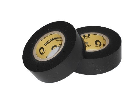

      I assume this is the stuff you are referring to?
      Find many great new & used options and get the best deals for 2 ROLLS BLACK NON-ADHESIVE VINYL WIRING HARNESS TAPE at the best online prices at eBay! Free shipping for many products!
      I can see the the barrel crimps would be much stronger than the brass open barrel crimps. But I wonder if after installing 10 in a single bundle that they would not be a little less bulky and probably provide enough support as a unit especially if covered with heat shrink.

        Yes, that's an example of the tape. You can either tie off the ends or use a brush on adhesive to lock it down.
