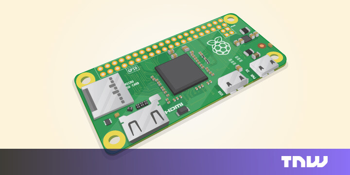

Speaking of the Pi, the next generation is purported to cost just $5. The Zero as they call it, is their smallest and cheapest computer to date - half the size of the model A+ and twice as powerful.
Raspberry Pi has just unveiled the Pi Zero, a programmable computer that costs only $5, or about as much as a cup of coffee.
- 1Ghz, Single-core CPU
- 512MB RAM
- Mini HDMI and USB On-The-Go ports
- Micro USB power
- HAT-compatible 40-pin header
- Composite video and reset headers
