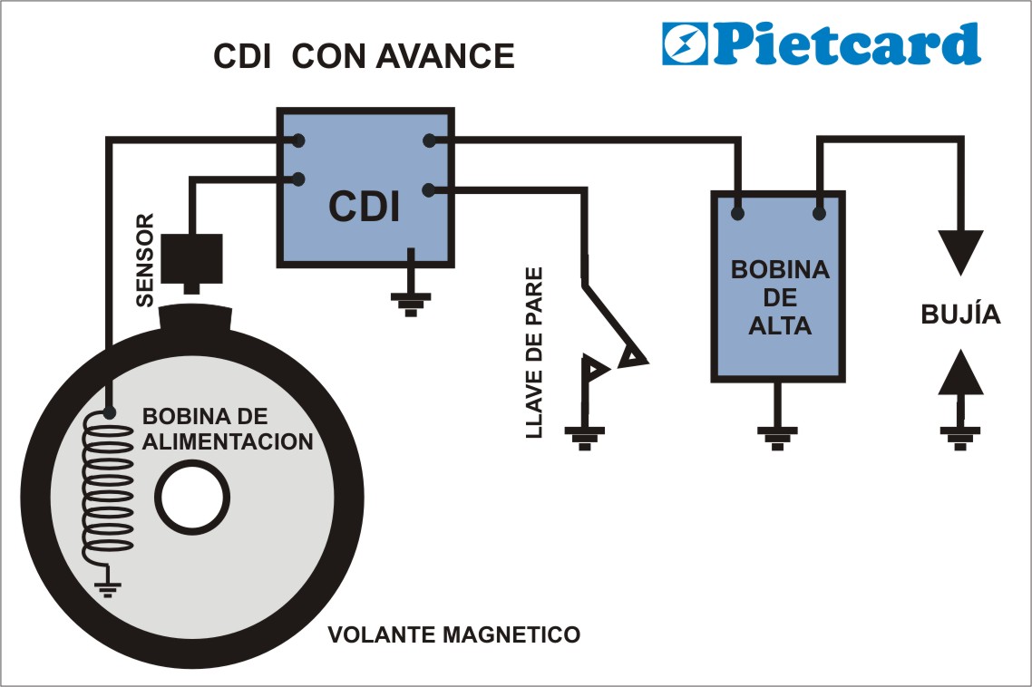

            Yes tom i looked at PIETCARD Homepage and there are 3 types of "CDI"
            the one that fits with mine is this
            but that wiring diagram isn't the same that i have in my bike ( maybe that is why its not working)
            i can try if that setup works, but i cant figure what " BOBINA DE ALIMENTACION (ALIMENTATION COIL) " is, may they refer to the stator?

                That setup with "BOBINA DE ALIMENTACION (ALIMENTATION coil ) " has to be for magneto style ignition- the cdi is charged by that coil rather than needing a battery to power it.

                    I went to tech support page and looked for 4 cycle. Translated this...............
                    Pietcard Electrónica, Fábrica de Equipos electrónicos, Motocicletas, ciclomotores, scooters y motonetas,Equipos de encendido electrónico y reguladores de voltaje,Banco de pruebas de CDI,Agrale, Appia, Artic Cat, Baccio, Bajaj, Betamotor, Blackstone, Brava, Cagiva, Cerro, Chirette, Ciclon, Corven, CPI,Dadalt,Daelim,Dayang,DEI,Derbi,Ducati,Euromot, Famsa, Frambretta, Gamma, Garelli, Ghigerri, Gilera, Guerrero, Hartford, Hero Puch, Honda, Hyosung, Imsa, Jaguar, Jawa,Jialing,Jianshe,Jincheng,Kawasaki, Keller, Kinetic, Koisa, Kymco, Lambretta, Legnano, Liming, Magister, Maverick, Modenas,Mondial,Motomel,Okinoi,Olmo,Panther,Peterson,Peugeot,PGO,Paiggio, Polaris, Prod. Náutica, Puma,Qjiang,Sayang,Siambretta,Sumo,Suzuki,TVS,Victory,Yamaha,Zadina,Zanella,Zap,Zongshen,Zundap.Distribuidora,Concesionario,Venta de repuestos,Taller mecánico,Usuario particular,Pilar, Santa Fe, Argentina
                    The 4-stroke engines required for proper operation of the ignition curve generates a variable feed rate and RPM in different RPM jump spark must occur at different stages of progress.
                    In this case it is a CDI (Capacitor Discharge Ignition) with electronic advance with a simple curve.
                    As its name suggests uses a capacitor that is charged to a particular voltage on the coil is discharged high at the time required for the motor.
                    This type of ignition coil comprising a supply, a CDI (black box), a sensor and a coil discharge.
                    By rotating the magneto coil generates AC power which is used to charge the capacitor with the positive half cycles.
                    This keeps the stored capacitor current until the circuit issues a trigger signal which depends on engine RPM so the advance curve is variable.
                    Regarding the sensor must be of type magnetic core with the magnetic wheel outside and with a cam drive of a size of about 20 25 degrees (measured on the circumference of the wheel)
                    Progress works as follows:
                    When the engine runs at low RPM CDI circuit takes time sensor signal with a delay in the firing of the spark is generated. Upon reaching 2000 RPM that delay is minimized progressively until 3000 RPM where it shoots straight.
                    Thus from 3000 onwards the engine RPM works with forward progress.
                    This minimum and maximum advance is directly dependent on the length of the cam that excites the sensor, therefore any alteration thereof change the ignition advance curve.
                    It is CDI and it needs a magneto coil on the plate. The unit determines it's own electronic advance.

                        Originally posted by Mailo
                        Posplayr i don't know if that tech information is for my ignitor
                        You don't? The text appears directly next to a diagram exactly like you posted above.
