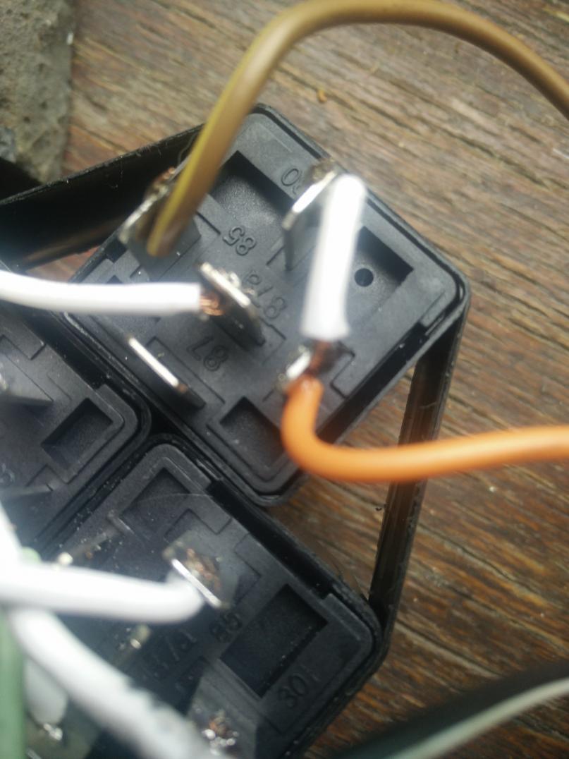

                        So I followed the wiring diagram the best I could but this thing isn't working right. It'll turn on my left turn signal and it will stay on (not blinking) until I hit the manual cancel switch. The right signal will turn on and stay on (not blinking) but won't turn off when I hit the manual cancel switch.
                        Can anyone help me out? Not really sure where to go from here.
                        I'm assuming something is wrong with the cancel relay so I put a picture of it up here.
