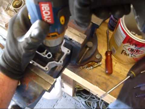

        I could use a bit of advice that should be straightforward: the head of one of my pilot jets is stripped, but it's tight in there. I see two options: get a jet from the dealer and try to extract the one that's in there or leave it in with the dip and hope that it's enough to clear any blockages. What do y'all think?

              I ordered a replacement pilot jet as recommended by OldVet, but am having a bit of trouble getting the old pilot jet out. There's still a bit of head on it that I can grab, but it's stubborn. I'm hesistant to use a screw extractor but I'm not sure what else I can do if it won't screw out for me. Someone I chatted with out here recommended a left handed thread drill bit.

                Recently I have become a big believer in the left had drill bit. I used one for the first time on a broke bolt and low and behold it unscrewed the bolt without having to use an extractor. Id think it'd be perfect for pilot jet removal.

                  I just had to remove a pilot jet with the head broken off 2 weeks ago. I tried a left hand bit, but it never really grabbed the jet to spin it out like I had hoped. It still worked out fine, though. I just tapped a torx head driver bit into the hole I drilled, and it turned right out.
                  This is the method I used (toward the end of the video)
