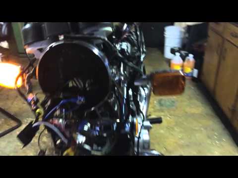

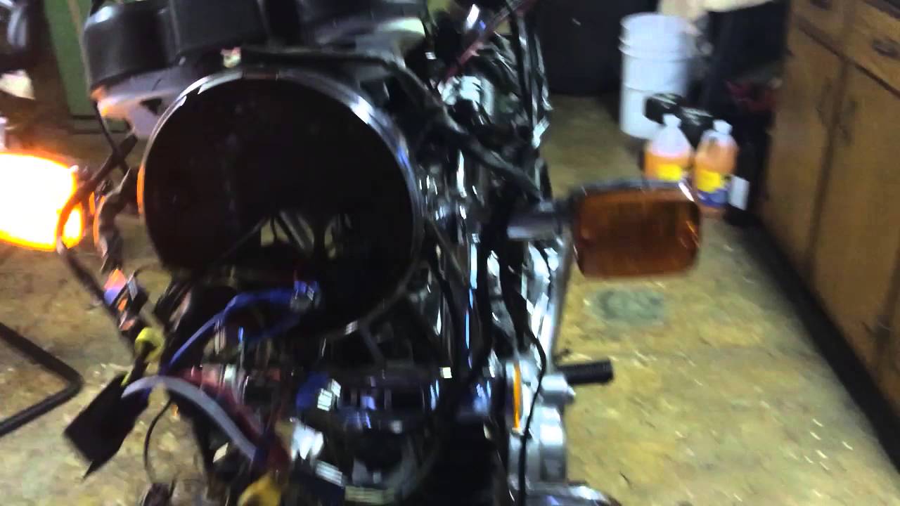

              • mnferwerda
                I've finished reversing the action of my blinkers. They are now normally on and now when I turn on the blinkers. they now blink "off". I swapped all the incandescent bulbs to LEDs. Here is a short video.

                  I like it. It is also a very good option when running LEDs as the two filiment style LEDs do not have much visual difference between HI and LO. This mod can be done with a 1156 single filament or by wiring both filaments together a 1157 style blinker can be converted. I would not wire two 1157 Incandescents together how ever as it will pull a lot of current. In fact this mod should only be done with LEDs, otherwise you will pull way too much power.
