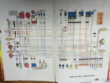

    Does the light just stay " on or off " ? Note the diode involved with this switch.... Similar wiring diagram

      My schematic only shows a switch (no diode), and there's a note saying that on 81 1100EX, it's for battery level. It also says its for side stand on 80 1100EL.
