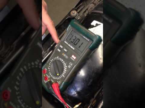

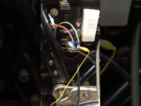

However, i'm getting curious readings at the battery terminals, and I'm not sure whether my RR is operating properly. Battery is a new Lithium Phosphate lightweight type battery, which very well could be a variable. Im not sure if the RR's activity changes depending on the load. I've taken 2 videos to show my testing procedures and results.

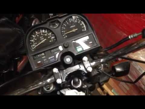

In the first video, i'm measuring the voltage output from the R/R between the hot and the ground leads. Seems extremely low, never more than 4 volts... curiously, the DC voltage DROPS as engine speed increases. not sure what to make of that. Seems wrong, maybe an electrical engineer can confirm or deny the weirdness.
The second video shows what happens when I'm metering across the battery terminals (via battery tender pigtail). Voltage is strong (13v), but doesn't change significantly with engine speed.
It's hard to tell what is happening, overall. The RR gets pretty warm to the touch, but not HOT HOT.
