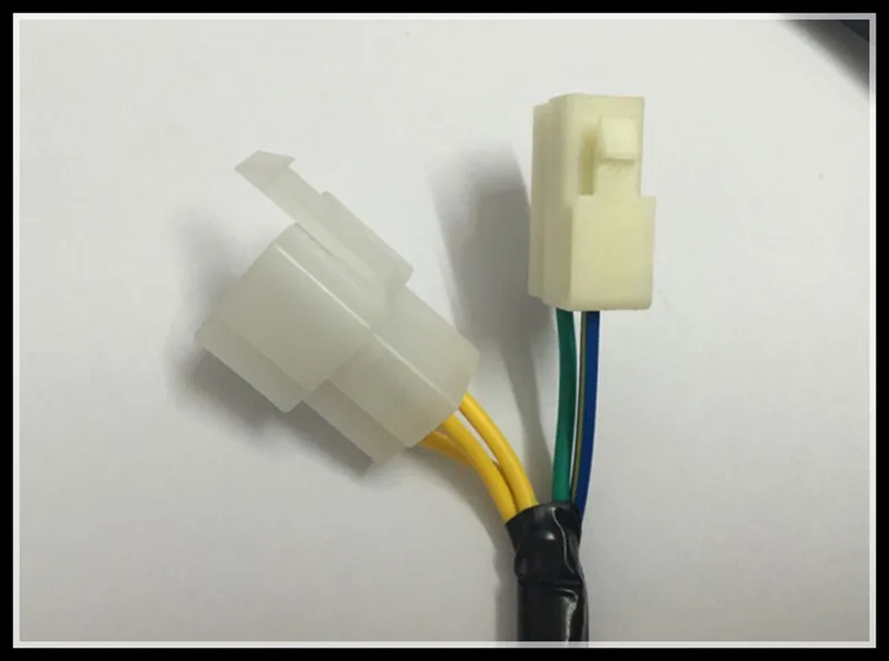

One of these from Ali-X. Listed as being for the GS125, but the measurements given in the item pics correspond exactly with two old stators on my shelf. I'll have to remove the grommet and with luck be able to re-use it further along the harness. No biggie, at all. I had spotted these before, but this seller is the first with the hole spacings measured in a pic, so it all looks fine.

I am curious about the two extra wires.

Yep. Easily snipped out.Originally posted by uk gs nut View PostCould the extra wires be an ignition pulse pick-up coil ?.
Not totally certain how the wiring take-off from the windings will need modified yet, but it should be do-able. If necessary, a simple solder and sleeve job with heatshrink and fibreglass tubing will do it - I had to do that before, so not really a problem.Last edited by Grimly; 12-04-2016, 09:57 AM.Dave

Originally posted by Steve View PostI am curious about the two extra wires.
Originally posted by uk gs nut View PostCould the extra wires be an ignition pulse pick-up coil ?.Yeah, they might be "easily snipped out", but they are probably occupying space on the stator poles that should be used for CHARGING windings.Originally posted by Grimly View PostYep. Easily snipped out.
I would be concerned that there might not be enough output from that stator.

Looks like only three wires are going to the actual windings. The two extra wire go to a separate module and could easily be removed from the system.http://img633.imageshack.us/img633/811/douMvs.jpg

Oh, I don't think it's output will be the full equal of the GS850 winding, but on a bike with all-LED lighting and series rec/reg it might be up to the task. I intend to run this to destruction to find out. If it's up to it, I will buy another couple of them for spares.Originally posted by Steve View PostI would be concerned that there might not be enough output from that stator.
