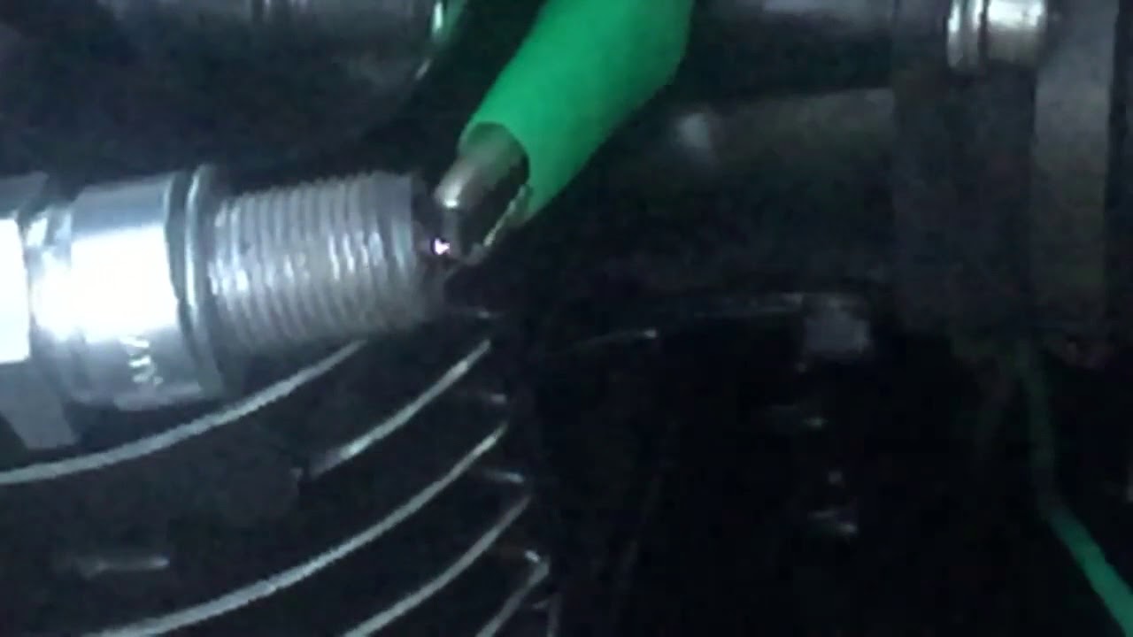

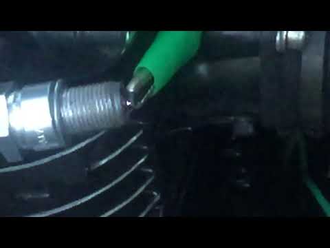

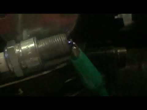

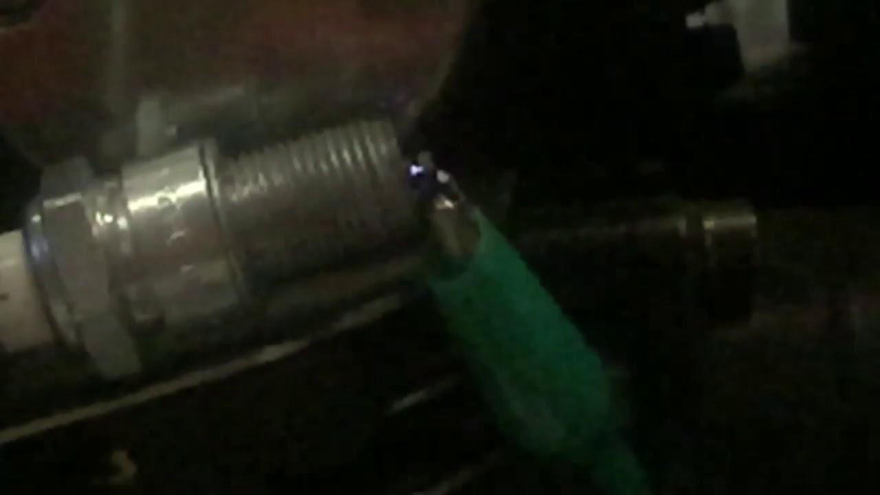

            Actually, I cheated. Did not get into my bike this evening, but shot a video of my bike with stock coils and my son's bike with its brand-new Dynas. After watching the videos on the phone's screen, the difference is somewhat less than impressive, so don't expect much.

                      OK, here are the videos.
                      850 with stock coils:
                      1000 with Dynas:
                      No extra charge for the slo-mo.

                            I learned a couple things in the process, as well. The first video I shot (not shown) showed a weaker spark, but it also showed that there was a spark between the plug and the head it was sitting on. I connected a jumper wire with an alligator clip to ensure a good ground and a spark in only one location.
                            I also learned that if you copy the slo-mo video from your iPhone to your computer, then post it to You Tube, you don't get any slo-mo, just full-speed, and it's just not the same. You have to use the You Tube app on the phone and upload directly from your phone to get the slo-mo.
                            Oh, yeah, I also learned that the spark looks pretty much the same between stock coils and Dynas.
