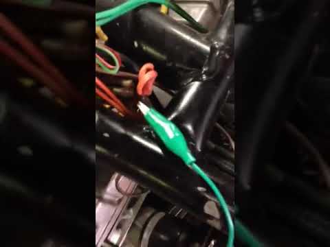

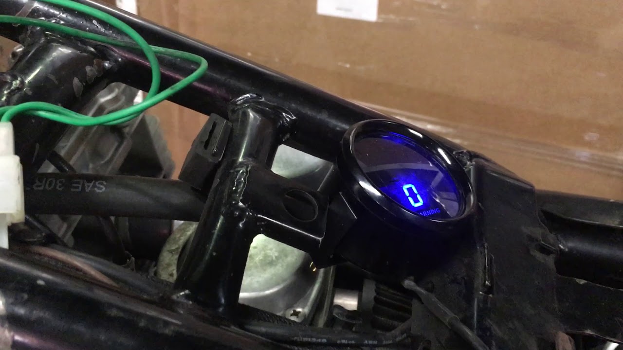

    Hi all. looking for any input on a weird issue.
    wiring up a digital instrument cluster from KOSO. have wired a few of these into various bikes, not rocket science, but this unit on my 81 gs1100E is/was acting strange, so i sent it back for warranty. they test it and say it works fine. Basically, when I start the engine, the unit starts to freak out, display random garbage, or shut off and turn back on, etc etc... when the engine isn't running, and Key is on, the unit is stable and fine. the manufacturer can't recreate my problem with the unit on their bench or other shop bikes.
    I tried hooking up another digital tach only to the bike, and the same sort of thing happens. I feed the tachometer signal information from the same place as where i tapped the KOSO gauge into. here's a video of it not working in the same way as the KOSO gauge:
    i'm taking the tach signal from the Left coil's "signal wire". each coil has a 12v+ ignition wire (orange) and a signal wire coming from the spark controller unit. to my understanding, that ought to just be a pulsed 0v- ground signal.
    the engine runs great, with or without a gauge installed, but neither gauge acts stable.
    any ideas?

        fair enough on the pic/video! it was a little video i shot for the original gauge manufacturer, but figured i'd share it here because it's all i had.
        so here's the instructions for what the original KOSO gauge wants, in terms of connections.
        the note @ the bottom of the instructions says the RPM wire must connect to the igniton coil positive pole... not exactly sure what that means. i wouldn't think it wants to see RPM information from the +12v supply wire, so it must be from the other (normally grounded) wire.
        am I off base in thinking that the 12v+ supply wire to the coils will generally be void of any sort of meaningful RPM data?
        the little unit from the video that was acting screwy had an instruction sheet that said to hook it up the same way as the KOSO unit pictured above.
        RE: Gorminrider - the diode you suggest would be attached to the 12v power to the gauge? my hope with running the gauge power directly from the battery (during the test/video) was to isolate any potential "doodad" interference going to the gauge's power supply. i have 12v diodes in my electrical bag, i'll try to patch one inline and see if it changes anything.
        thanks for the help! Like I mentioned, i've installed these types of gauges before, without issue, which is why this one is having me scratch my head.

                          Installing a jumper wire to disconnect the R/R produced no changes in the tachometer activity. Still erratic and goofy. I think AC leakage can be ruled out for now.
                          i tapped the gauge signal wire into both the orange/white wire, as well as the black wire going to the coil, and there was no difference in the tach activity. Both spazzed out and lost any meaningful display capabilities.
                          curiously, but maybe telling, is that when the tach signal input wire (on the gauge) was disconnected, the gauge was generally stable, showing 0rpm. When I attached a long jumper wire to tap into the coil wires, the gauge started to tweak a bit. But that’s before I even attached the other end to a coil wire. Seems like the longer lebgth of signal wire was acting like an antenna, and was seeing RF interference.

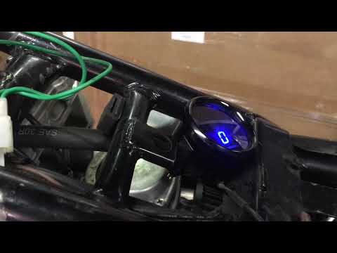

                            resistor plugs arrived in the mail yesterday, I installed them and also tested the digital tachometer, and everything works.
                            so for those who dont read the whole thread:
                            My digital tachometer/speedo unit was acting very strange, certainly not working at all. the company checked it out, said it's not malfunctioning on their bikes. the problem ended up being on my end. I had installed non-resistor type spark plugs (NGK D8EA) and also intentionally removed the resistors from my new NGK spark plug caps/boots, and did not use "suppressor" type spark plug leads. this leads to the production of RF interference from the coil/plug secondary circuit, which wasn't an issue on my vintage bike until i tried to use a digital gauge. Plugs are the easiest of the 3 to change, so I swapped them for NGK DR8EA, with the "R" indicating that the plug has a resistor inside it. after installing the new plugs, the tach works just fine.
                            also, as far as the wiring is concerned... the way i had initially wired it was correct, where the gauge wants to see it's RPM information from the "ground" side (black/white) of the coil leads, not the battery side. which is confusing after this whole discourse, because the instructions say to use the "positive pole" but I tried to use the battery side wire (orange/white) and the gauge read 0 RPM while the engine is running.
                            to see a video demonstration:
                            (the gauge needed calibrated, still... the RPM value shown is 1/2 of the actual engine speed)
