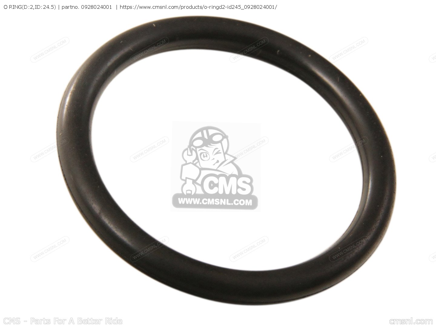

      If you remove the motor you may need to think about replacing the o-ring at the sharp end of the motor or oil will leak out from the generator space. This is the 850 part, generally easily available from engineering suppliers.
