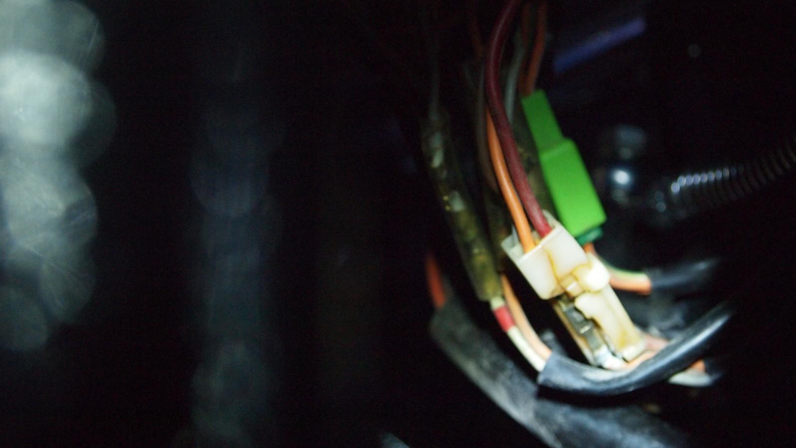

    Okay, so while replacing my front brake lines last week I decided to clean up the triple tree area while I had access.
    Upon wiping down the black nylon bag behind the gauge cluster I heard stuff fall out & hit the floor.
    Pieces of a connector- great! Further investigation discovered this(see attached photo).
    If my research is accurate I'm looking at the ignition switch connector. The wire colors and count are my only tip-offs.
    Searching within vintageconnections.com I locate these:
    My questions for the most all knowing are: Is this truly the ignition switch connector I believe it to be?
    And, Are those connectors above from vintageconnections.com the direct 'plug-n-play' replacements for the ignition switch (or whatever this connector is for)? Mind you the harness looks great overall, so the terminals are A-OK...they just need a 'stable stable'
    Thanks in advance.

    Yes,
    the red, orange, brown, gray harness/connector is for the ignition switch.
    Red from main fuse
    Orange goes back to the fuse block to power the Head, Signal & Ignition fuses.
    Other two are for the tail light (and tail light only) circuit, in ON position the two are connected so powers the tail light with same circuit as the other signals. In Park position the red (main ) is connected to the brown tail light wire, so the tail light (and tail light only) is powered by the main fuse.

      Confirmed, that is the connector for the ignition switch.
      Confirmed, yes, the connector from Vintage Connectors will work just fine.
      Not sure if the actual brass terminals will work in the VC housings, but they probably will.
      If you need confirmation of that, I can find out in the morning.

            Judging from the picture the contacts in the connector got oxidized/corroded which caused excessive heating, which in turn causing the plastic connector housing to become brittle.

              OK, I looked at the '80 850G parts bike, here is what I saw:
              It took a bit to separate the connector halves:
              The release pins in the brass tabs did not want to co-operate by actually releasing, but I was at least able to verify that the connector shells from Vintage Connections DO mate properly with the OEM connectors:
              I would suspect that if you could get the brass pieces out, they would likely snap into the new housings, but based on the condition of the wire just outside the connector, you would probably be better off just snipping them off and installing new ones.

                The female (pin side)shell shows clear signs of heat melting the plastic. The male (pin) side looks like it has some type of dielectric grease; hopefully that has stabilized the situation. I guess it is aparts bike, but it is still good for members to be able to diagnose what they are looking at.
                  • 35924
                  It's also somewhat important to know that ALL of the current required to run EVERYTHING on the bike goes through two of those rather small pins. The red wire comes from the battery (until the R/R takes over), the orange wire carries the current from the ignition switch to the fuse block. ANY corrosion or dirt in those two sets of pins will heat things up quite nicely. You can see the slightly-melted plastic in that last picture that you showed.
                    Wow! You've gone all out, Steve - Thanks once again! Yeah, I saw that corrosion around the end of the crimped areas. I'll go thru it more thoroughly once the VC parts come in. With extra pins there's no reason to not use them where it's this critical. I wasn't completely aware of how much current this connector sees, so I've learned not to compromise here. I'll post how it all goes in the next few weeks.
