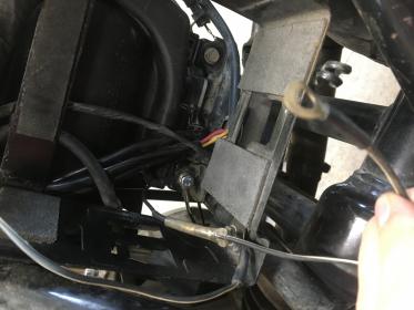

    Hi.
    im currently rebuilding my 1982 GS650 GL and there is one cable i cant seem to find its place. I think its a ground cable going from the left bolt(looking from the battery side) of the regulator/rectifier to somewhere. Its the same bolt that another ground cable goes from the regulator/rectifier itself.
    Anybody knows?

    That?s a bridge wire to ensure that negative battery post gets a good ground to battery box frame....best to run another ground wire to r/r ground eye to avoid corrosion issues,
    Read up in forum on ?single point grounding? ....the r/r needs to see battery negative correctly or fun will ensue!
