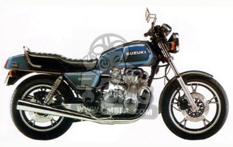

I guess 1st you'll have to double check the part number to see if they sent you (or you ASKED for) the correct harness with an eye to sending it back for the correct one.
There's sooo many models...EZ would seem to be particular but...see cmnsl link to check the part number or possible alternates they sometimes list
failing any joy there, I'd guess you'll want to know exactly which bike suits the harness you have in hand and explore the differences from the wiring diagrams between yours and it. This is leading to you modding the harness OR the connections on your bike so you're going to want a good crimper and the appropriate connectors..and even, "maybe-hopefully-not-but-not-as-bad-as-you-might-think" unwinding the harness tape to splice any additions in.
✓ Suzuki spare parts for GS1100 Motorcycle. ✓ Swift delivery ✓ Original Suzuki GS1100 parts

VIN? just find your bike. My best guess, not having your bike, would be below. There are THREE harnesses listed....it's detective work for sure and maybe without result but 'the truth is out there" if you can find it. As to what good it'll do if your particular harness is no longer available, you'll have to mod it.
This is the only one that has been available since I rebuilt my GS1100ED (2008). Are you sure you have an 82(EZ)? It looks very similar to the 83 (ED) (9" round headlamp). The 80/81 are very similar (square headlamp) and have a different harness. The only other harness is the ESD which was a limited production (full fairing)and rare as hen's teeth.
