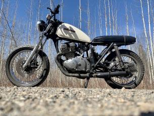

    Ive been loving my little 80 gs250t. I’ve done a bunch to it and it has been running great this year.
    Here’s my situation. I was out for a ride the other day, cruising along, maybe a gear up to run a bit quieter but nothing unusual. All of a sudden bike starts chugging, losing throttle power. I pull in the clutch, rev it a bit, bike dies flat. Hit the start button, nothing. Off I get, walk around the bike and there are no lights. Zero electrical power. I manage to bomb start it going down hill and it runs, not well, no lights. I limp it home, running, I can’t go over about third gear, bike starts chugging, still no lights.
    I love troubleshooting. I check everything, main fuse, good, ignition, good, start button, good, battery, good. The only erroneous readings I find are off my regulator/rectifier. It’s a reactance check and I find no readings from the w/r wire or the y wire. I’m hoping I found my problem, just wondering if anyone has seen this issue. I’ve ordered the part and will keep this updated as to my findings. Two weeks for parts, gives me time to put some new tires on, maybe paint a few more bits. Thanks for your time, stay safe.
