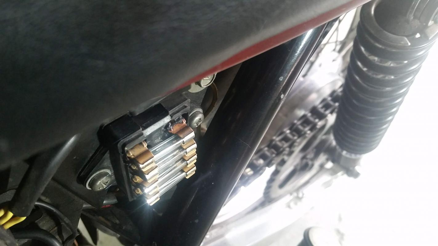

    In the morning I rolled the bike out of the garage. The main fuse was intact. The engine started promptly, as it has always done, but soon began coughing and sputtering. I shut it off and touched the headers. All hot, except number three. I rolled the bike back into the garage and felt the electrical connectors in my brain heating up. The known knowns are a good battery and generally sound electrical health: the headlight works, low and high, as do the turn signals, the horn, the brake light, oil pressure light, neutral light, speedo and tach lights. I think it's got an Electrosport R/R that's at least eight years old, and an Electrosport stator, installed at the same time. Dyna coils and ignition. Valves were inspected and within spec 300 miles ago.
    As a prelude to the methodical tracing of wires and connectors, riddle me this: is there an obvious connection between the blown main and misfiring third cylinder, or are there many possibilities, with patience and study required. Been looking for a non-agricultural project, and suspect I have found one . . .

    Hello mate, good to see you back here! Sometimes those glass fuses just get old and thin! If the charging voltage is decent when it’s running I would just check connectors and the back of the fuse box to make sure the connectors are all good back there. Sometimes they benefit from re-soldering (just re-melt the solder that’s there).
    I would expect it not to be related. the cold cylinder would most likely be some gunk that moved and blocked the pilot jet.. does the cylinder run at higher revs and/or with the choke on? First thing I would try would be a high dose of sea foam and ride it again... Cheers, Dan

          As I was looking at the carburetors in preparation for removal, my eye went to the three float bowl vent tubes, all of which were uncapped/unhosed. Something stirred in my memory. I found a rubber cap and put it over the vent to the left of #3 carburetor. Bike fired right up on all four cylinders.
          At some point years back I removed the three tube hoses as part of the conversion to pod filters and a V&H exhaust, and later getting a tip from someone here to cap the #3 vent. Would someone remind me why it needs to be capped, but not the other two?
          As to the blown main fuse, closer inspection showed that the clips holding the main fuse had sagged somehow and were able to touch one side of the fuse holder immediately below. If this caused the main to blow, why didn't it take out the fuse directly below?

            John that's exactly what mine did! I suppose the main fuse blew first because the one below either wasn't drawing anything or didn't have a path to short through. Take the fuse block off, you may find the plastic is work or melted. I re-soldered (melted) the joints & then potted (filled the back cavity up) with clear epoxy and it's been fine ever since (probably a dozen years and 20,000 miles since then..).
            I posted some pictures here somewhere.
            That vent you're talking about is not the vacuum tube for the petcock is it? If you have a manual petcock then yes that one has to be plugged. On mine (with pods) I don't have vent tubes, just the fuel pipe & the vacuum pipe going to the petcock, nothing else.

                      CSI Sacramento has determined that it happened like this: main fuse clip touches fuse clip immediately below, killing all power, causing the engine to chuff, causing the carburetors to cough the old cap from vent tube #3 . . . golf tee seems the elegant solution, or maybe a miniature laboratory-grade stopper . . .

                        Did the fuse box melt at all?
                        Remove it and check the back as Dan suggested. Clean all of the connections
                        Then, pull your head light and remove your ignition switch
                        Take it apart and clean it. If it looks pitted, sand the contact s with very fine sandpaper to provide a clean smooth surface.

                              Charring on the front . . .
