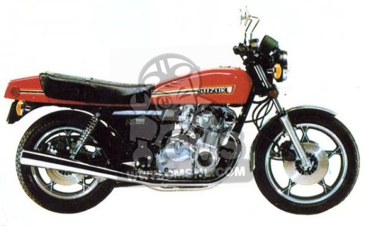

start here , but be sure you really have a "1981 GS1000GL". If they call it something else, check the handlebars and seat for a visible match.
✓ Suzuki spare parts for GS1000 Motorcycle. ✓ Swift delivery ✓ Original Suzuki GS1000 parts
be sure to click the name on the parts list- it will tell you which bikes use the same part.
