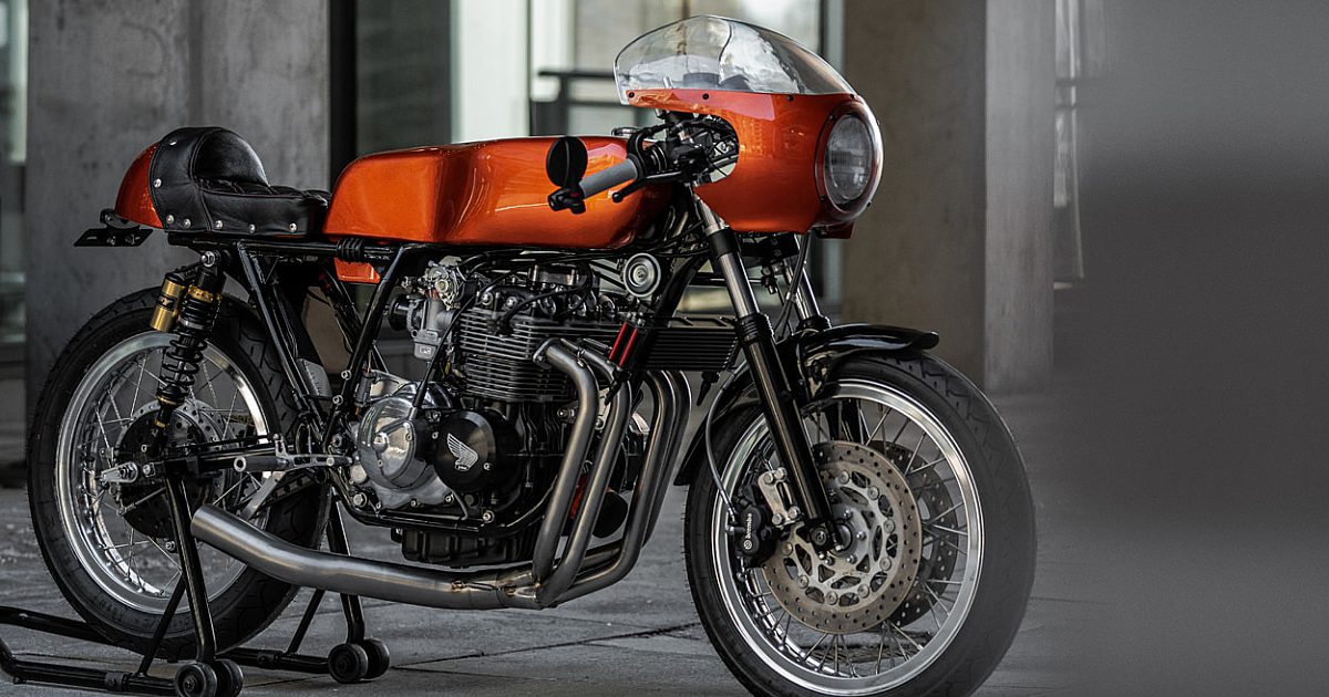

                  Yes, he was the guy who helped design the Honda in line fours. He left Honda and started Ontario Motor Works, turning CB400F's into CB458cc to 4999cc bikes the regularly ate 1000 cc bikes of that period for lunch. My bike red lines at 14500 rpm's. He turned my stock carbs into smooth bores and flow benched the carbs into the heads into the hand bent exhaust he made for me. I also did many other things, like a much more powerful oil pump, forged pistons, shot peened the rods. Gold Anodized aluminum D.I.D. rims with stainless steel spokes. It is truly a great bike of it's era.
                  This link speaks of him a bit. Some research will yield more.
                  Yes, they still make 'em like this. A Honda inspired by Kaz Yoshima and his CB that ruled California in the mid 70s.
