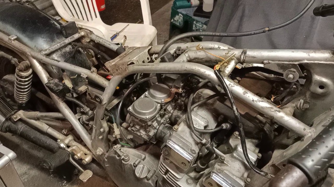

        Well, I put a new battery in it this afternoon and it actually turned over after I jiggle the clutch lever. I wonder if the switch is loose or if it is just that way. Anyone have that issue with the clutch lever? Didn't let it try to start for too long as I don't know what the oil is like in it. Tomorrow it gets new oil and a filter. Then I'm going to hook up an auxiliary fuel tank to bypass the petcock and see if it will actually start. Compression sounded good while it turned over, no galloping.
          here is a picture if the bike when I went to pick it up.
