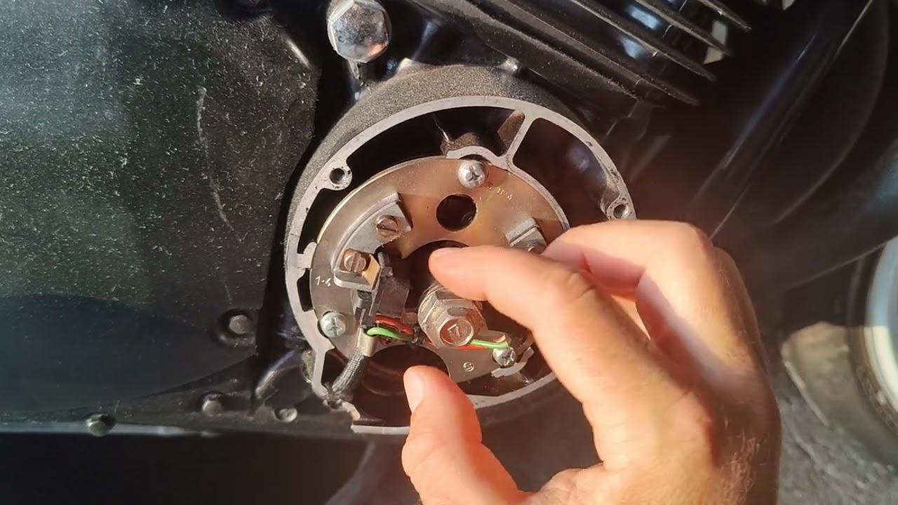

    Fourth - is "fully relaxed" the correct place for my ignition timing to be set?
    I made a real silly mistake on this one. While I was messing around in the cylinder heads with the bore scope, I pulled off the timing cover to get at the crank shaft so I could rotate the engine to see the bores fully.
    While I was in there, I got excited about tuning up the ignition timing before I looked close enough to realize that my hasty assumption that this bike would have a points system was in fact incorrect. (it was night time and the lighting in my garage is really bad, I swear I'm not normally this careless). Unfortunately, I cracked loose the smaller shaft-end bolt that sets into the end of the crank shaft so I could start adjusting stuff, and now I'm not exactly sure where it was set before I started messing with it.
    So now I'm a little unsure how much of a problem I may have caused for myself. I'm not really familiar with transistorized timing (I'm pretty new to doing my own timing in general!), I don't have a strobe, and I can't find much info at all on how to do static timing for this system. The thing that I thought was the breaker cam, which is in fact the signal generator, seems to have a "rest position" that's all the way counter-clockwise on the shaft, and it appears that I can turn it clockwise to advance the timing before re-tightening the retaining bolt.
    I know that advancing the timing too far can cause knock and damage an engine badly if done carelessly, and as far as I understand retarding the timing too much will just tend to cause the engine performance to be poor and possibly make it hard to start, so my instinct is that the safest thing will be to leave it at its resting, least-advanced position and tighten it back down again. And if my memory is correct, the position it was in before I cracked this bolt loose was at or near this position already.
    However, since I've already put myself in this position of not being sure, I'd like to know - is it common for people to mess with the timing advance on these bikes? Is there a recommended best practice here, or a common adjustment to make? Am I missing anything important in my analysis outlined here? Any reason I should do anything besides just leave it where it wants to be and tighten it back up?

      Forth: the electronic ignition system isn't adjustable. Don't worry about messing anything up, unless you broke something.

        4: I'm probably not the best person to advise on this, but I have, in the past, dealt with the ignitions, both stock and Dyna, and it seems fairly simple and not easy to goof up. But you know, I found a way. I remember assembling it 180 out of whack once and getting a terrific 'bang' backfire. No damage thankfully Then realizing the error of my ways I reversed it and all was good. Others will chime in but I think it is sort of simple (?) and there's only one screw-up you can do - which I did. Don't quote me though, it's been a while. The manual should help and careful examining of the mechanism.

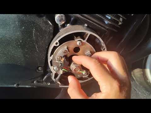

                Y'all have got me wondering now if I understand even less about the ignition system on this bike than I think I do haha
                I took a short video on my phone to show the component I mentioned in my question 4 above. I thought it was for timing adjustment, maybe someone can tell me what it actually is. Video link attached...
                  • 35809
                  Tighten that screw back down, then twist the rotor, and make sure it rotates and snaps back, just as it does during the video. It's supposed to do that. It's a mechanical spark advance mechanism. With high rpm, the advance mechanism moves, advancing the timing. If you want to be super fancy, pull it all part, and lubricate the mechanism, so it moves even smoother, and stays that way.

                    Great, I'll do that haha. I guess I got worried over nothing!
