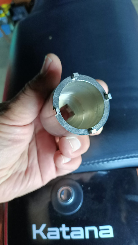

The first one - can I remove the *upper* bearing and bearing races with a bicycle-style puller (the kind that looks like Elmer Fudd's gun after he's tried to fire it with a carrot in the muzzle)? It seems the lower bearing and faces come out with a reasonably gentle application of a mallet on a length of pipe or similar, and J really don't think I can stomach $200 for a single purpose tool I will hopefully only use once or twice per bike.
The second one - are there any special tools it's worth buying for this job?
