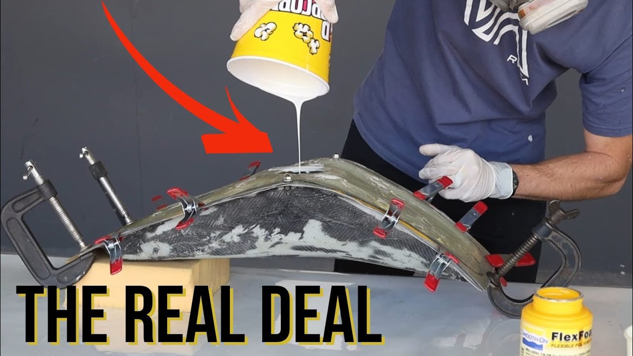

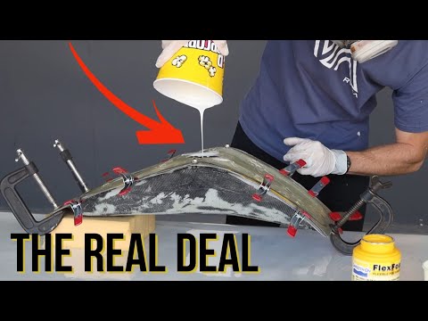

                    Google is your friend. This took 3 seconds. Try words like “poured foam to form a motorcycle seat”
                    Just one of many results:
                      Interesting. However, dirt bikes aren't known for their seat comfort on long distances.
                        Point is, yes, a squishable foam can, and is possible from a poured-in-mold process to make a motorcycle seat. This is the process I believe Chuck has in mind as a alternative to the typical build-up-layers-of-varying-density-foams-then-cut/shave-to-shape process. Obviously, more research is needed on his part to find out if it’s even something that should be considered for a street bike seat, and if so, what would be the best recipe to use.
                          Its easy IF you have a slight clue of what to google.. ha ha.
                            Awesome I'll be watching along to see how it goes.
                              That pourable mix as in the video is exactly what i was thinking about. Take my stock foam and do a layered fiberglass mold on it. Do the same on the pan so the recesses also get formed in the pour. Separate mold halves and clean up seam runout just like he did in the video. If it works then i have a mold for making them on request for members.
