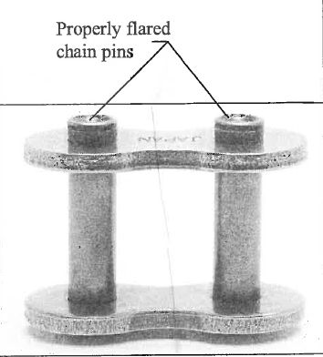

                      I have to agree with Souske, vice grips dont stand a chance. I just bought a motion pro, 3-in-1 tool from Z1 that worked ok (MP08-0058 http://www.z1enterprises.com/Chain-R...-Tool-382.aspx). I don't have any affiliation with Z1 - I am just a satisfied customer). The tool is good enough for the odd use, but I didn't heed the reccomendations and broke the "breaking tip". If your old chain doesnt have a master clip to remove it, grind off the rivet head before trying to push it trough with this tool, otherwise you will break the tool like me . Any force on the tool will break the tool, and not push the old rivet through.
                      I just bought a 110 link chain for my 550 that requires 108 links, and I just took two off.
                      The flaring is minimal, and the tool gives you instructions on how to do it as well. Here is a properly flared pin according to them:

                        When I flared my pins, I used my digital calipers to measure the before/after peen. It was about 0.025". It's also good to ensure they're even.
