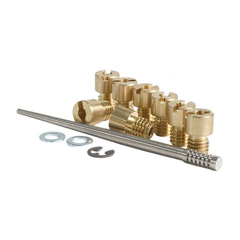

            Is this the jet kit I need?
            or this
            • koolaid_kid
              #36
              The second one.

                            Your 1978 should have VM carbs. There is no Dynojet kit for those. HTH
                            • FreshmanJoe
                              #44
                              Here's the jet kit for a 78 gs 1000. http://www.dynojet.com/jetkits/motorcycle/suzuki.aspx
                              Although I'm too broke to do the pods and jet kit it does exist.
